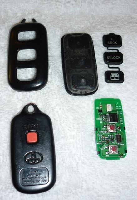

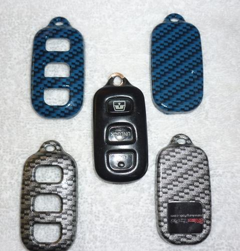

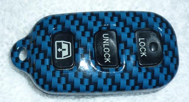

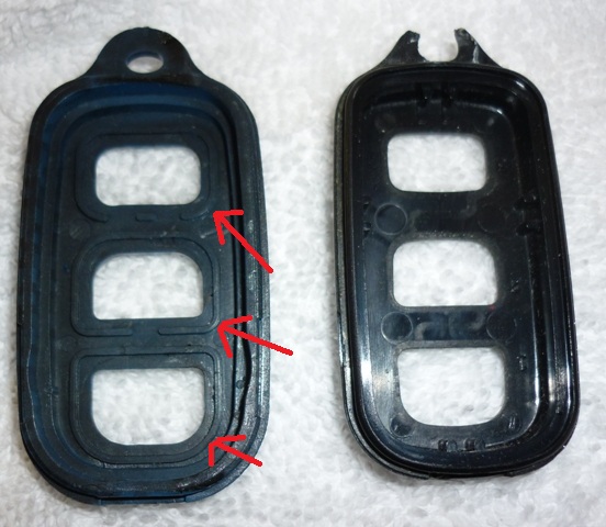

Got mine in today. They are not exact swap but close enough if you're willing to mod them a bit. As I mentioned earlier, no panic button.
There is a raised ridge on the inside of the fob that needs to be trimmed to accommodate the piece of plastic that connects all the buttons. I also had to ream out the lock and unlock button holes a tiny bit to get them to not stick. If you look at the final photo, you can see where I did it too much especially around the lock button. Based on the photo, you may just need to do the top and bottom of the button a bit. Looking at the fob, you can't seen the error but they showed up on the photo when I zoomed in.
Overall not too bad and better than my super glued washer. I got blue and silver 'carbon fiber' ones. The blue looks OK but I really don't like the silver. BTW, the cheesy label on the silver one peeled off without complaint.
Here are some photos.
edit: Just did the silver one. I didn't have to ream out the button holes on this one but still had to flatten the insides. The other thing I discovered is that they go together much better (and it doesn't seem to affect the buttons as much which is why I was reaming the holes) if you put the electronics into the back housing and then the rubber cover so that it seals the electronics into the back. Then snap this onto the face where the buttons have already been installed.
