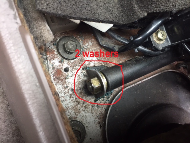

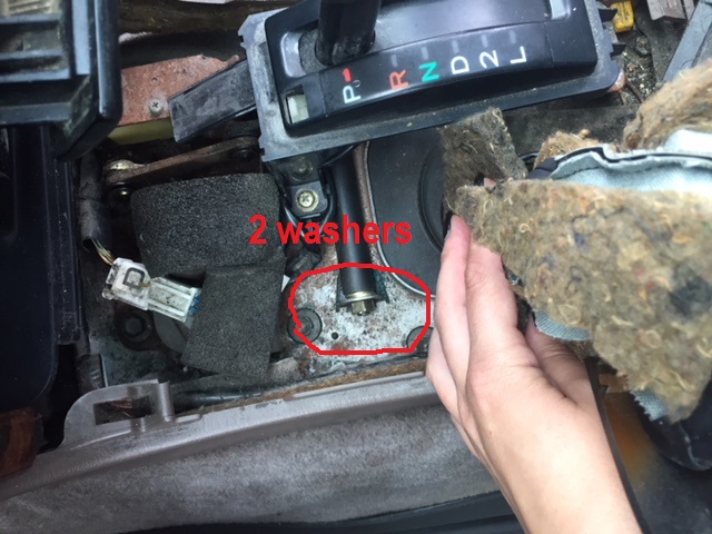

Hi guys - I know this is an old thread but this just helped me a lot (thank you!) figuring out what my (new, sudden) problem was... I had to come up with a slightly different solution though so hopefully this may help somebody else.
As others have said the peg was not catching the white plastic piece because there was too much play in the shifter. It was too loose and even pushing it all the way to the right when putting it in park wasn't working.
I grabbed a couple of washers and put them on the left of the sleeve for the bottom of the shifter, tightened everything back up, and... So far so good!
https://www.yotashop.com/toyota-oem-shifter-lever-bushing-33548-31010/?utm_medium=googleshopping&utm_source=bc&gclid=EAIaIQobChMIw6vmse_M3QIV03J-Ch2_Ng8zEAQYBCABEgLkPPD_BwE
Washers will work, here are the bushings, if you replace them and adjust the shifter the key issue will solve itself.
and the shifter will be nice and tight, also it wont rattle.
Yes, the washer or the actual bushing is the solution. I was fixing mine and noticed plastic shards from the old bushing. I used 1 thick washer and it's a little tricky getting it in place. Slide the shaft bolt toward the shifter, then you might have to slightly pry the shaft & bolt to give you enough space to work the washers into place.
