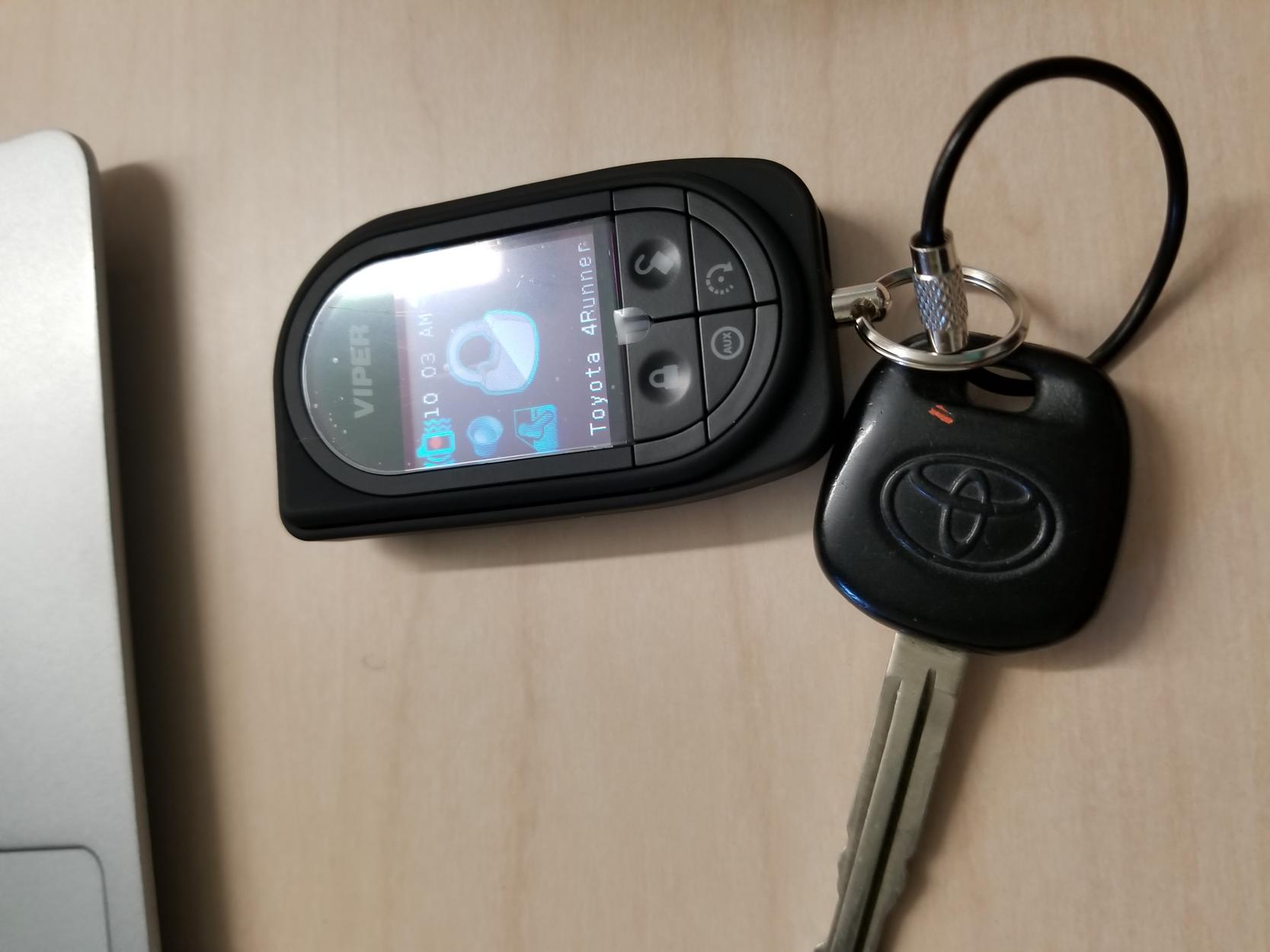

I got the Viper 5906v installed a few days ago and it is probably the best alarm on the market. The auto start works real good and I have tested it up to a half mile away and it starts right up. Just set your heater to a comfortable setting and fire it up while you're making your morning coffee. Also has the option for the smart start app which allows you to start your car from anywhere you have cell service. It was a little on the expensive side at $680 installed but financing is available at most shops.
