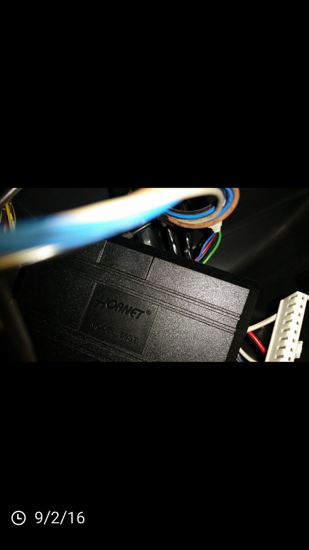

Mine has a sticker when I open the hood that says "this vehicle is equipped with keyless entry.blah blah battery disconnected blah." I just never received a remote when I bought it. : (
Look under the dash for the remote brain.
You should be able to get a remote for it if it's still there.
You might have to go to an installer to buy it and get it programmed.
After reading it again it actually says remote start as well. Any idea where to check for that
Found it. Unplugged under the dash. Can I program any remote to these things or does it have to be the same brand.?
No you need a Hornet 476H remote or perhaps a 475.
Here's how to program them.
Reprograming Alarm/starter Hornet Remote - Car Forums and Automotive Chat
If you momentarily ground the white/blue wire you can test to see if the thing will remote start. It might have been disconnected for a reason.
Also I think it is an alarm as well so all hell might break loose or it may disable your ability to start the vehicle with a key after you hook it up.
