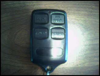

Oh ya , the old key fob sure wasnt Toyota . I thought it may have been a replacement fob thats all . I see you have a 99 , my first post that mentions about the unlocking sequences with the key , does yours do that too ? Once , drivers door will open and if you turn again all doors will unlock with key . Same with locking . Just more than curious if thats a factory thing or aftermarket thing ? Really I just want the keyfob system to work again , I have been to all the places that sell replacement fobs BUT ( just my luck) this is NO description or FCC ID anywhere on the outside or inside of the fob , which makes it a PIA to replace . Guess I will have to hunt down the box inside the truck somewhere.

What does your key fob look like? Sounds like it might be aftermarket.
This is what it looks like ( sorry for crappy cellphone pics )
Clockwise buttons are LOCK , UNLOCK , OPTION , TRUNK

Yup, definitely aftermarket.
And the unlock sequence (using the key) is typical. Once for just driver door, twice for all doors. However, ALL doors should lock when you turn it to lock the first time. At least that's how it is on mine.
