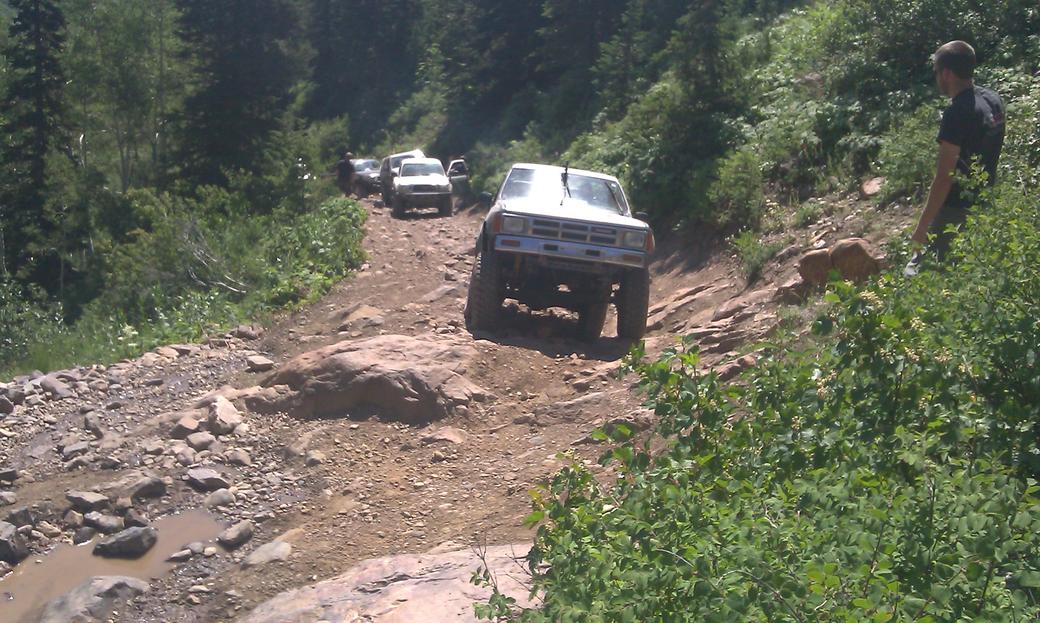

Saturday fun on Mineral Basin in American Fork Canyon:
IMAG0943_zpsd626f65e.jpg~original
IMAG0945_zpsaa7e1d51.jpg~original

I wheeled the Grey Bastard about as hard as I have yet this weekend, really pushed my boundaries. I made several obstacles and harder lines that I've bypassed on previous runs, and got to know the truck and my own ability a lot better. I also beat the crap out of the poor truck, which ought to make [MENTION=3959]slacker[/MENTION] happy - my drivers fender and both rear quarterpanels/mudflaps gave their lives for the cause, and the passenger door is on the walking wounded list.

cool .. looks like fun
don't know why I would be happy about your carnage though :shrug:
unless , your going to "trail test " our products :)
nice trips and carnage. i run my BFG AT at 15psi during the summer. most the guys i know with mud like you have, run 10psi. you should air down more next time since the max of those tires are like 35?
