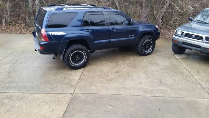

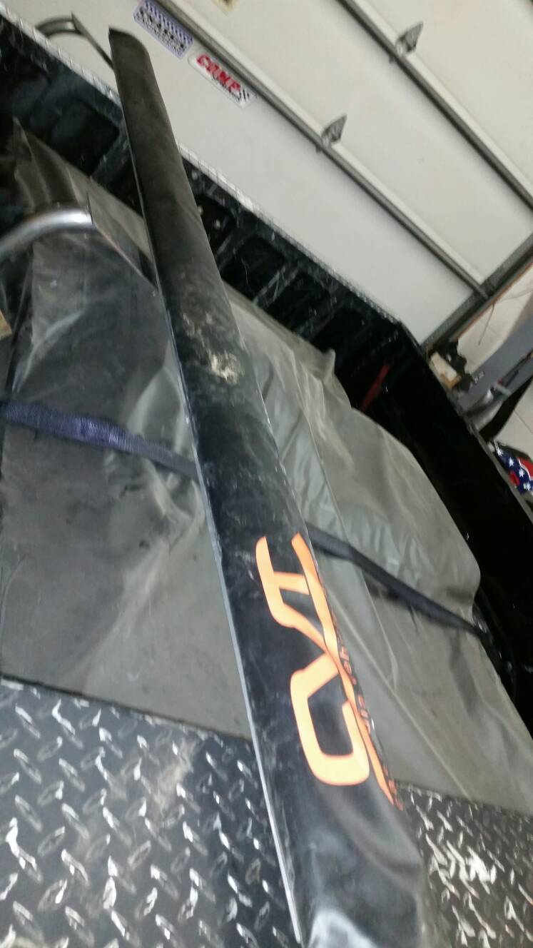

So I have owned a few 1st gen 4runner and tacomas. I bought this 4th gen when we had r first kid. It already had a 2 inch spacer lift borla exhaust, pro comp wheels and 285 tires that where new. I forgot to say I work at a toyota dealership. I've always wanted always kind expedition vehicle/ hunting truck and tk pull my boat. After putting new brakes and calipers on it. So I sold my tacoma and started looking for a roof top tent and found one one craigslist that the guy had only opened up one time and never used it. uploadfromtaptalk1458094455995.jpg
It is a cvt mt Rainer with annex and awning for 1400 so I bought it.uploadfromtaptalk1458094505973.jpg
I'm going tomorrow to a local guy to have a swing out bumper built out of aluminum and ordering shocks all the way around. There is other things I'm going to do but since I just had my first kid this will b a slower build. Going to make my own roof rack out of 1x1 box tubing and then mount tent. Hopefully I will b camping real soon with it.

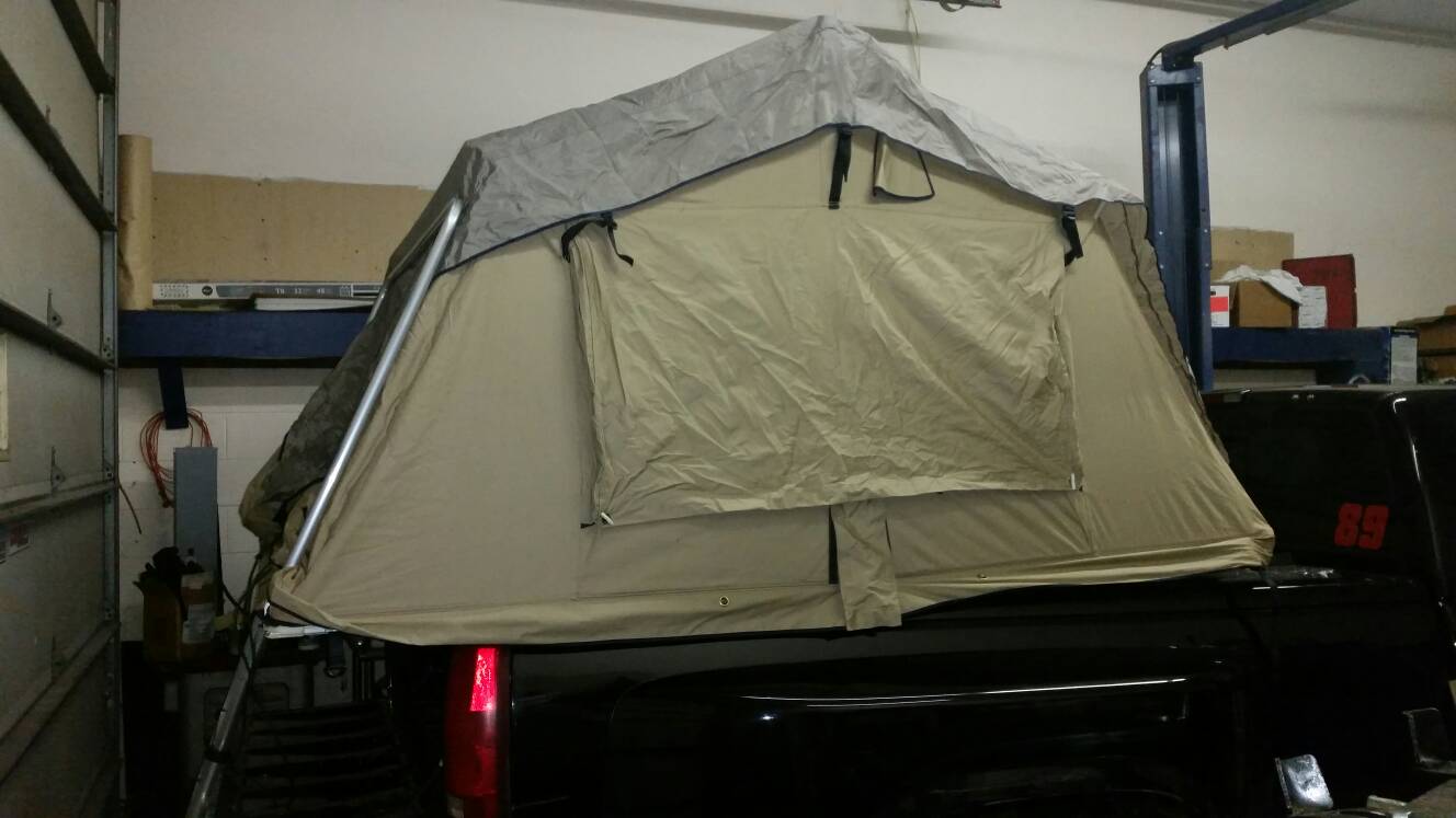

I have never opened up a roof top tent or seen one in person till todayuploadfromtaptalk1458186117432.jpg
I opened it up sitting on my dually and I'm super happy with how big it is.
