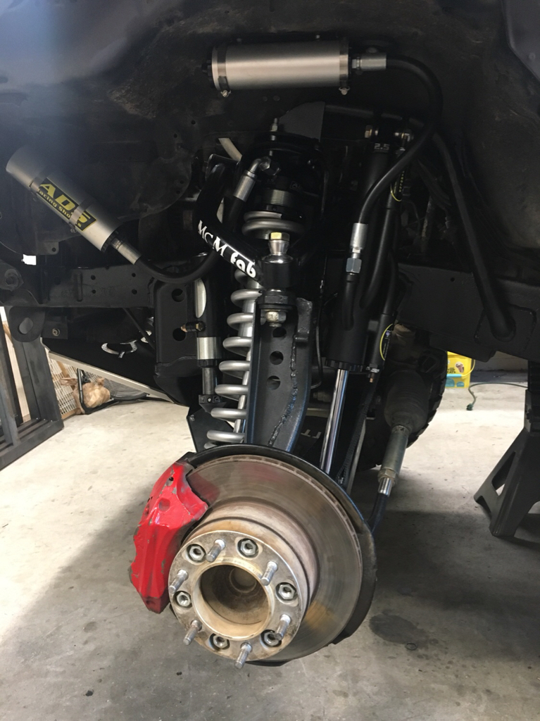

I’m a little bias towards ADS but absolutely love their products and customer service. We are a dealer for ADS and happy to get you set up with exactly what you want. There are a few members on here that just recently bought ADS coilovers w/ resis from me and seem to love them.
As for the rear, ADS doesn’t make a 3rd gen shock currently. However, the FJ cruiser 2.5” piggyback will work great in the rear for a lifted application. At 9” of travel it is a great upgrade. Unless you plan on going LT in the front I don’t see why you’d need a rear bypass setup.
My current ADS setup:
278,379
