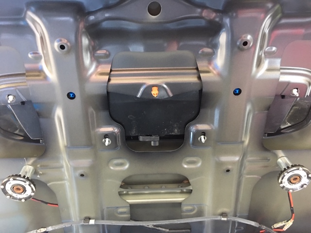

So this is just a fun little project I did because I'm a nerd and grew up watching Knight Rider lol
And before the haters start whining I am perfectly aware of the legal issues with having a red flashing light on front of a vehicle. Its for "offroad" use only don't try this at home LMAO.

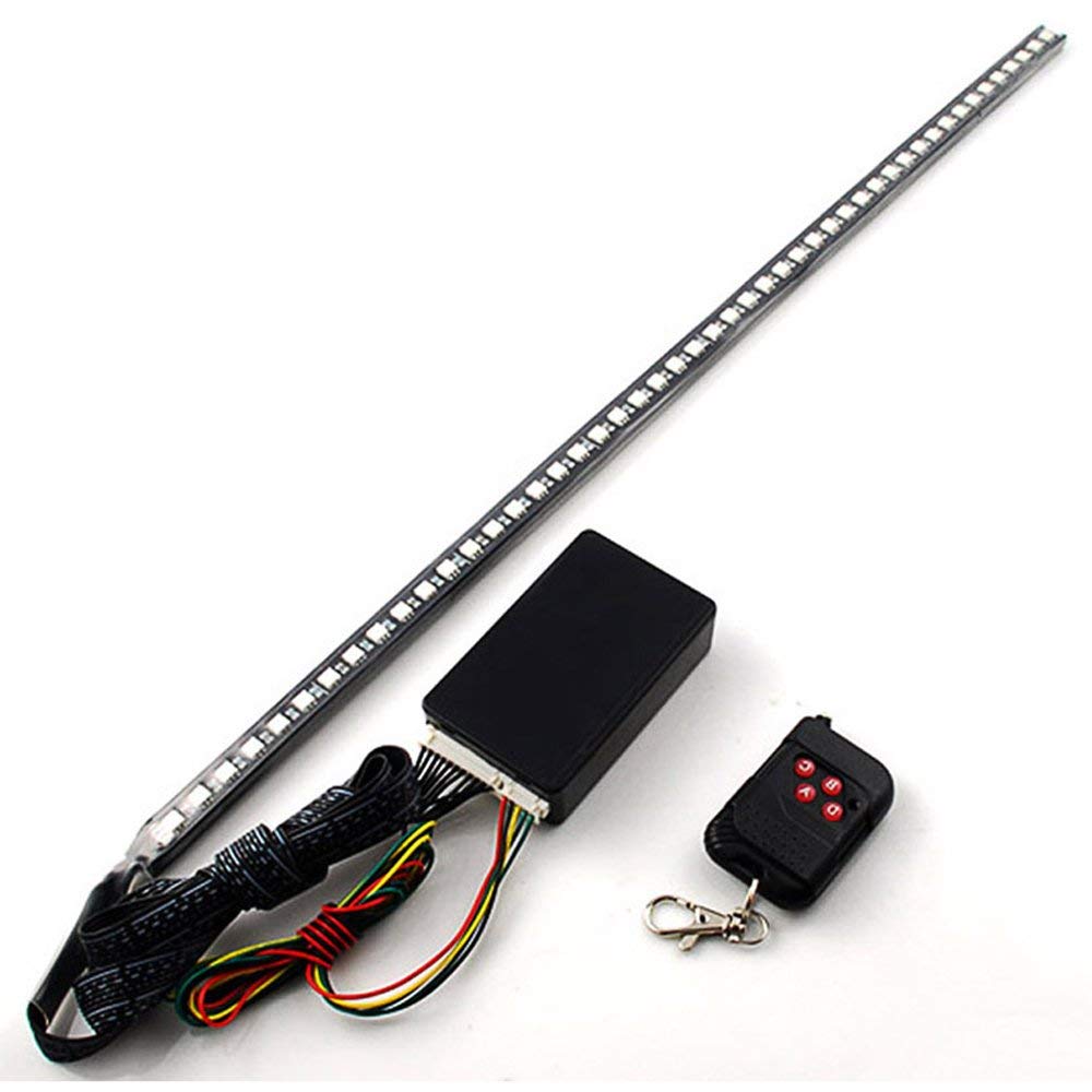

So I bought this cheap $15 led scanner light on amazon
https://www.amazon.com/Astra-Depot-S...ateway&sr=8-11

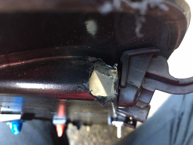

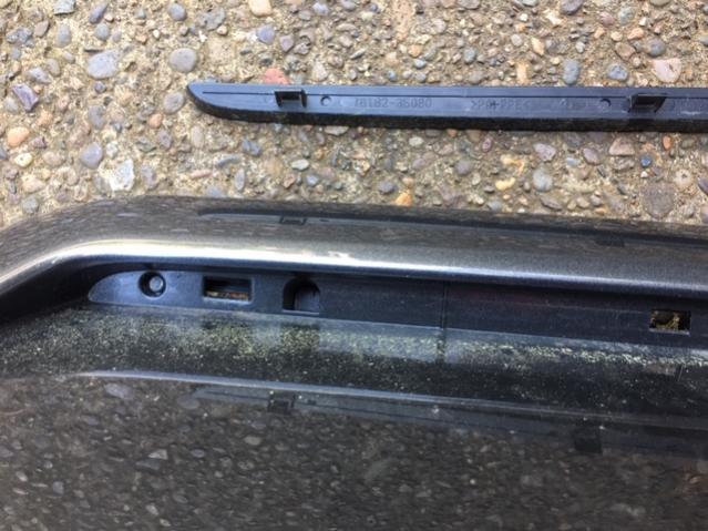

I removed my hood scoop, cut a hole on each end of opening to slide this light thru, I had to flex and bend it slightly to get it thru.
It was way too long since the light is 22 inches and the scoop opening is roughly 17 inches so I had to cut a few inches of the circuit board off the end. I sealed the end with some gasket material.

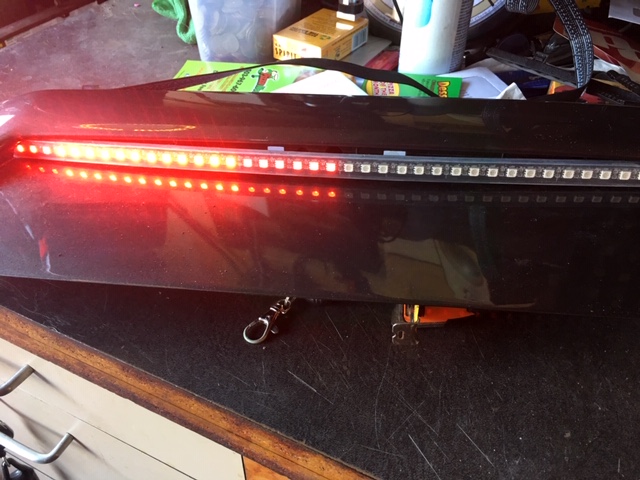

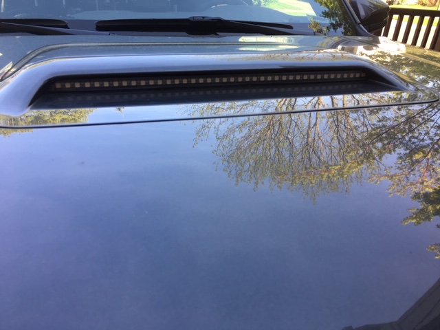

Then I stuck double sided tape on back side once I was happy with placement and tested it first.

Honestly, this is fantastic. I've seen on this forum where people were interested in doing something like this. Great work, should be a sticky in the DIY section.
The 4runner scoop is super thin opening, it is only a 1/2" tall opening so Ive had a hard time finding a suitable light to use that is waterproof and narrow enough to fit. So far this was the best I could find. I don't know how long this $15 light will last under the hood. We will see
I debated opening up the scoop to make it functional or doing something like this. I saw on I think a Tacoma forum where they can fit a slim light bar in their scoops so they must be a little taller
