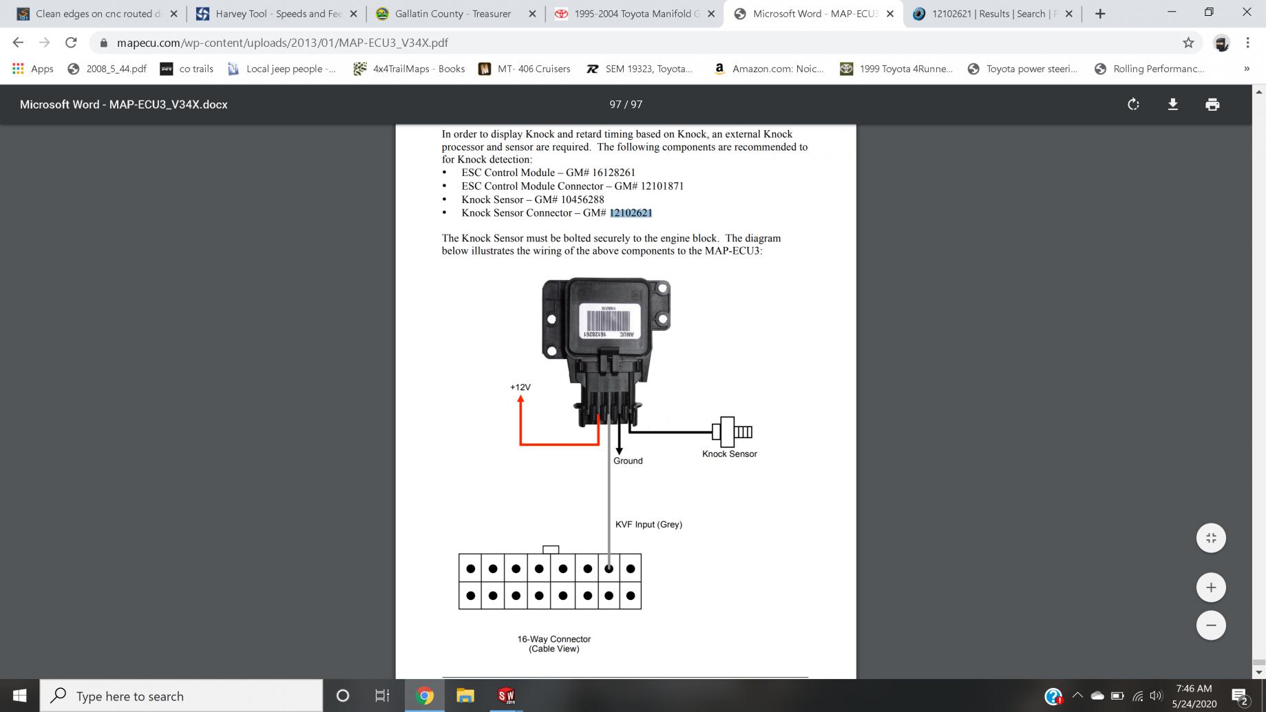

Definitely will post the results in a few weeks once i get it up and running again. Pretty sure I know the thread you're talking about over on CT, read through that a few times when I was exploring the option of ditching the stock sensors all together.
Also heres the mapecu wiring diagram for the knock sensor setup, it already uses the gm knock sensor processor so that simplifies things. I wonder if you could run the stock sensors through that gm processor to the mapecu and just use them instead of that 3rd sensor. The one thing I am struggling to figure out is how to setup two sensors off that gm system. Not sure if I can just run them both off the same wire or if I am better off doing just one sensor in the middle of the cylinder valley. If I had to pick one side for mine to put the sensor I think the driver side would be best since thats the sensor that failed and leads me to believe the side that knocks the most. Very glad I choose the mapecu over the urd 7th or something, its really nice having a piggyback with this much capability

Is there really a need for knock control below 3K RPM? On stock sized tires (realize if you have larger tires but same gear ratio this could be an issue), I don't spend hardly any time with heavy driving under 3K except when going up the pass on I-80 towards Tahoe. Even then just popping out of overdrive takes care of that.
When I want to go fast, 3K RPM's comes and goes really quick...
My truck is re geared to 5.29s but it weighs a little over 1200lbs more than stock and is twisting 35s. I dont like climbing long passes like on I70 screaming at 4k rpm in 3rd to maintain 60. At that point the blower isnt even making boost so what was even the point of installing it. I like being able to hold 65 to 70 at 2500 to 3000 rpm when climbing most hills. I have a shift controller that allows me to force the torque converter to stay locked and in 4th gear. Works really well and its nice not downshifting on every damn little hill I come across. Basically treat it like my turbo car where boost is what carries me up things and vacuum does the rest. So in my case knock control below 3k rpm is really important
