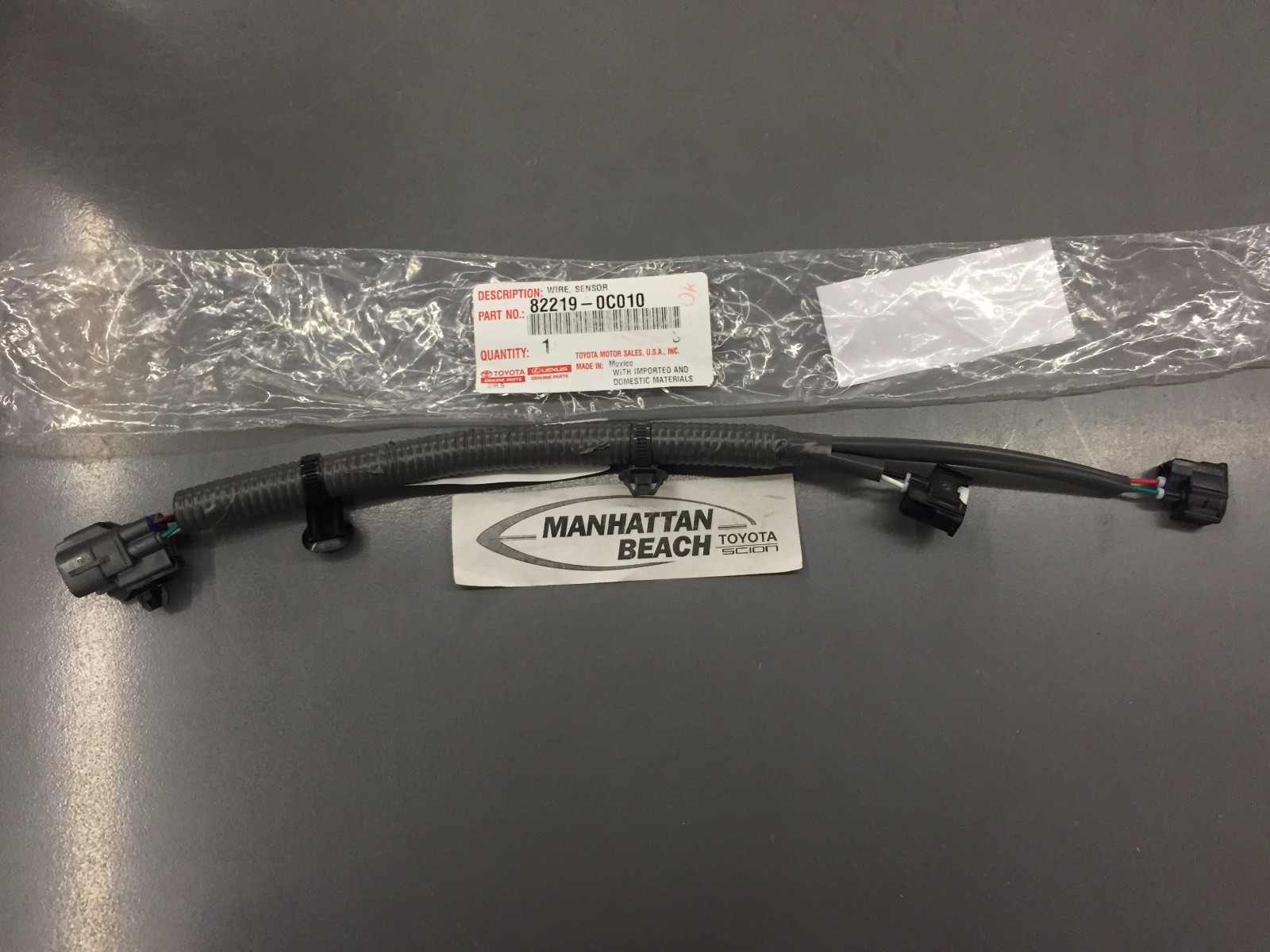

It can be. $26 at dealership. It’s basicall a pigtail that connects the two knock sensors to the main wiring harness. About 16” long.

I have that sensor wire for sale on our eBay store if you are interested.
Note: This part is for a V6 for the V8 looks like is the whole Engine Harness.
eBay Item Number: 221980964375
$24.98 +TAX +SHIPPING
