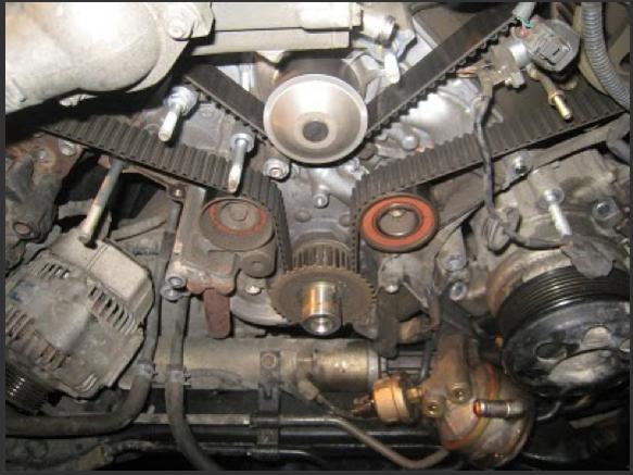

A slight wobble of the crankshaft pulley is definitely not normal. It's very possible the bolt is coming loose, or there is something messed up with the crankshaft position sensor plate (see photo of it, the plate with teeth, pulley removed).
