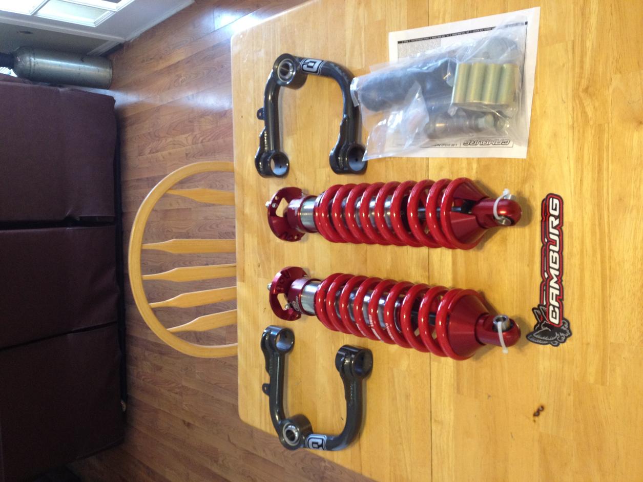

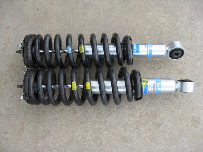

Interesting cause I have read numerous threads here, toy120 and toyotatech that refer to them as struts. Even when I went and purchased my billies 5100s the fronts were called struts just sayin:hiding:
Top pic of Billies (Struts)
2nd pic coilovers
2nd pic coilovers
