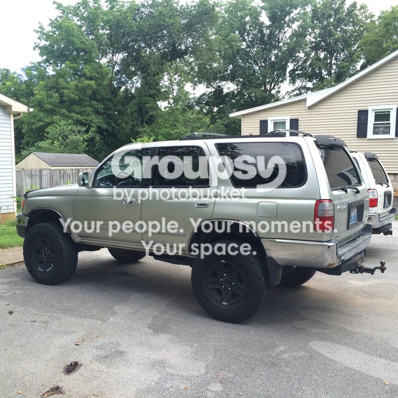

The trucks is a factory e-locker 5 speed, with a partial SS 1.2 lift ,as some of the items from kit aren't present, like the Diff breather extension and some other small tidbits.
Here a few pictures of it since I got it. I'll make sure to post all the pictures I took of my trip back from Wyoming and since then once I get some time.

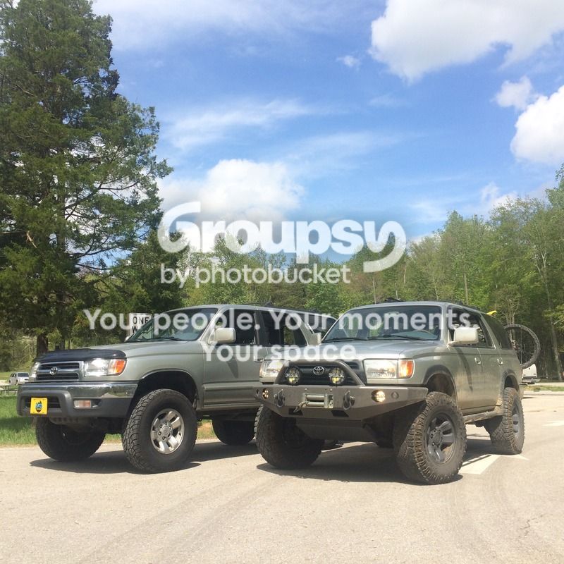

Parked at Mammoth Cave next to [MENTION=87942]Scotty_h[/MENTION] 's amazing rig after doing some riding around Big Hollow trail here in KY.

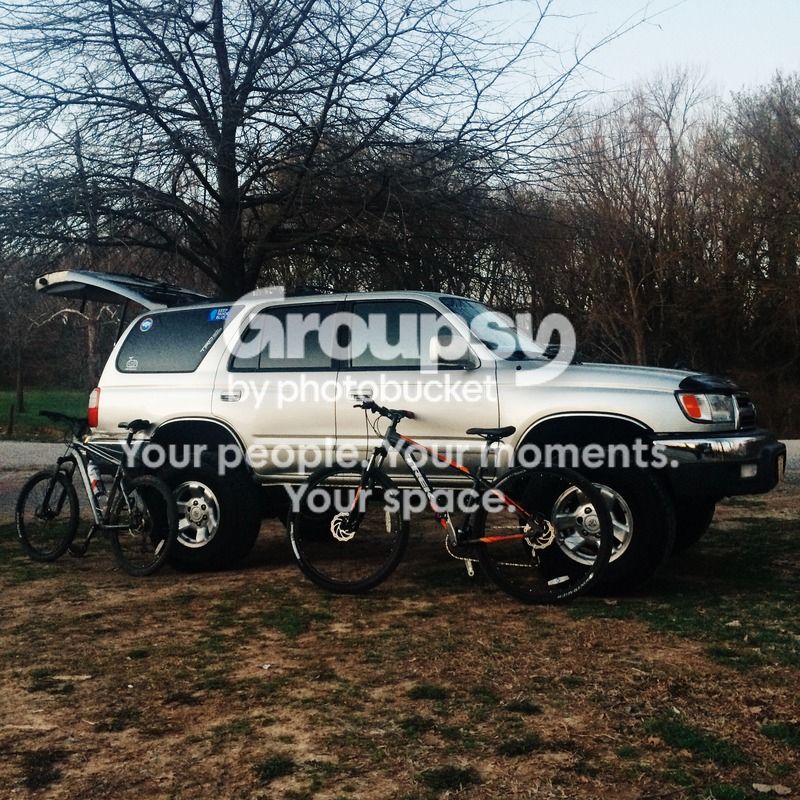

Thanks for the comments on the bike [MENTION=128568]jaimesleo[/MENTION] . The bike is actually a softail Giant Anthem 650B though. I do however have an older Trek 4500 Disc from 2010 that I use from time to time.
You ride much?
You ride much?
Yea i was talking about the grey and orange bike. I ride mtn and road. Ive been trying to look for a trek 4 series. Buying them new is kinda expensive. But i do love to ride.
[MENTION=128568]jaimesleo[/MENTION] , forgot I posted that pic. That's my sister's latest outdoor purchase. She is starting to get into the swing of mtb.
