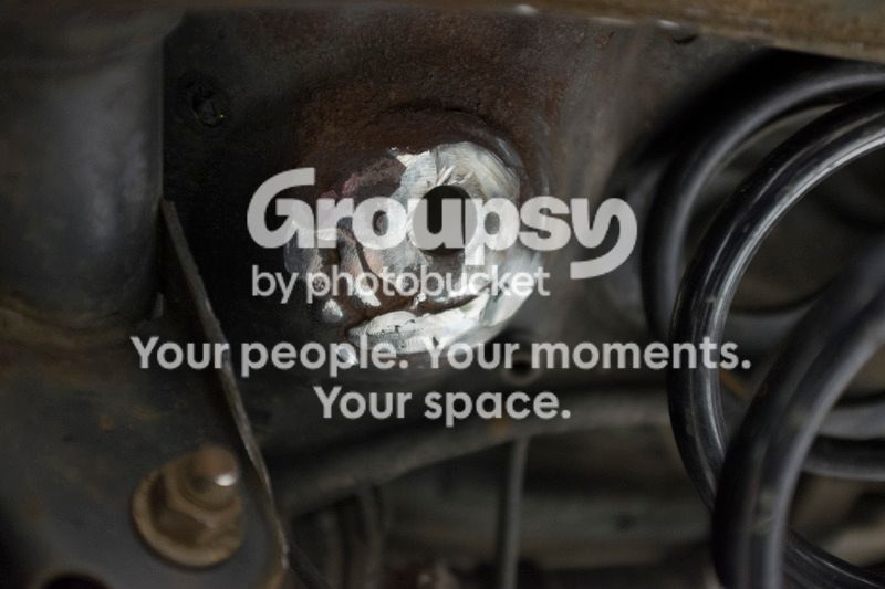

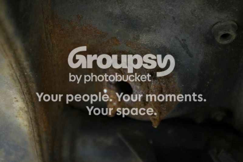

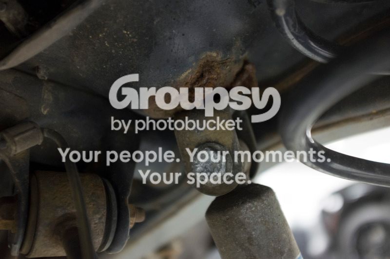

The other issue I had to sort out in addition to replacing the shocks was reverting back to the OEM style shock rather than keeping the setup that was installed previously.
That meant grinding down the rusty welds that were in the way of installing the bushings on the threaded portion of the new shocks and coating the underside to protect from any additional rust. That process took the longest after I got it up in the air and removed the old shocks and springs.

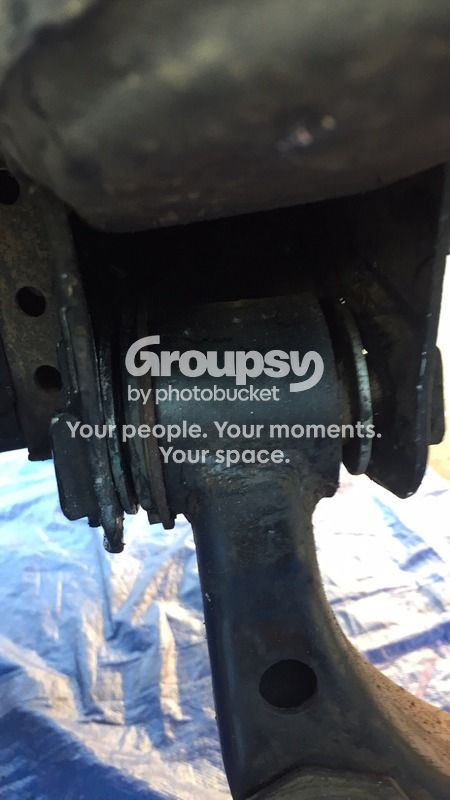

Long story short they discovered my issue is worn out lower control arm bushings, causing the assembly to bind. They were quick to offer me a solution. It was pretty simple really. They wanted me to fork over $2,400+, and they would replace all my lower control arms, bushings, sway bar endlinks (which I have disconnected on purpose) and then I’d be all set.
I chuckled to myself, and told them thank you for their time. I asked them to please rotate the tires and that I would take it from there.

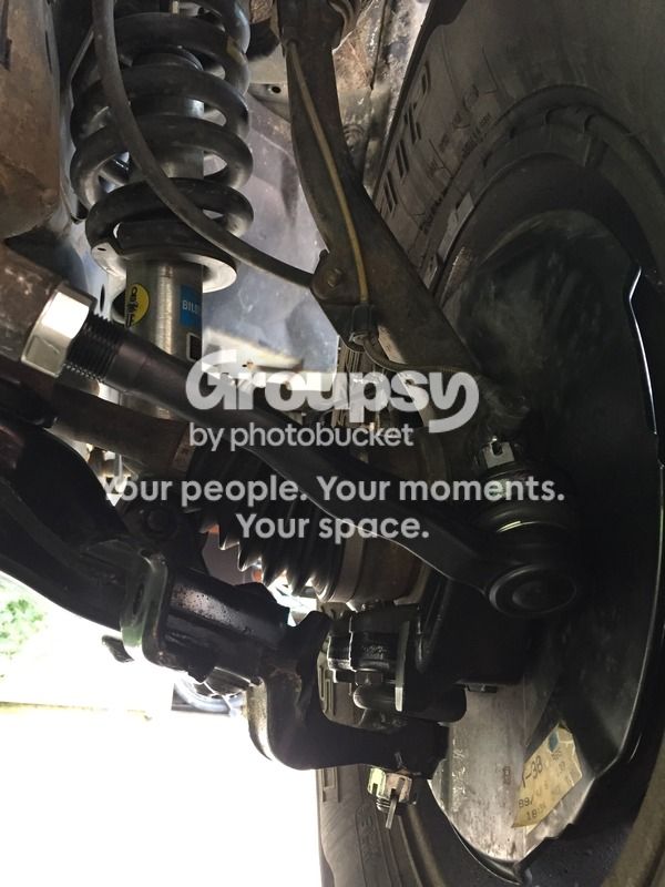

Since then, I've taken delivery of a couple of LCAs from a well connected junkyard owner friend of mine, and then ordered a set of bushings for each control arm. Those were around $204 bucks for OEM bushings when all was said and done. Yesterday I changed those out at work with the help of some experienced shop guys in the back.
1DC33F36-999E-49AF-9541-8B6940800E5D.jpg~original

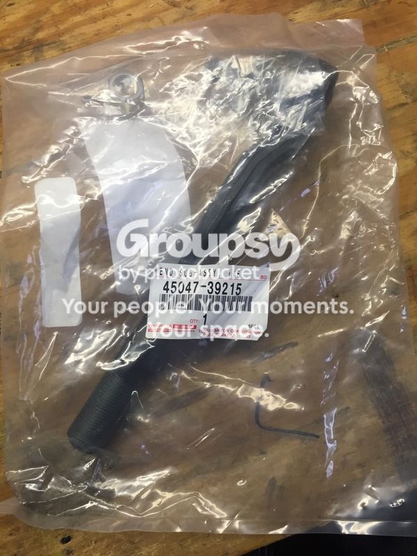

I have also learned that you have to move the steering rack out of the way a bit to slide the front LCA bolts out of their holes. That is disheartening but at least it gives me an opportunity to replace the steering rack bushings. I purchased Energy Suspension kit part to handle that specific task.

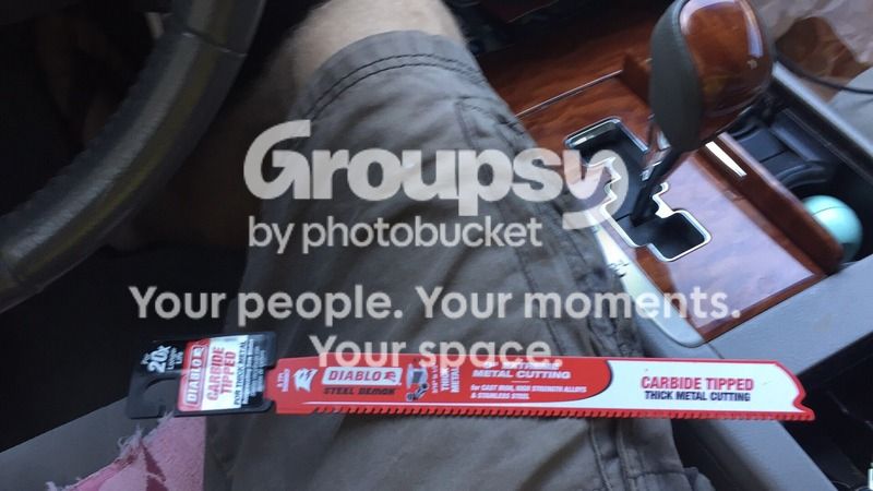

The rearward inside bolt was seized in the cam sleeve. Ended up spending a lot of time with a hammer and a pry bar to no avail. Ended up borrowing a friend of mine's Sawzall (Note to self: purchase one) and then took a trip to Home Depot to buy this:
FullSizeRender2.jpg~original
It worked a like a charm. Less than a minute of cutting and I was through the sucker and it's been helping me with some random brush removal off of a fence line at the house since then. Diablo is good stuff and I am now a fan for life.
I also replaced all of the bolts, cam nuts and cam sleeves with new OEM units, partially to make sure it could be adjusted in the future, and also to make sure that I wouldn't be stuck with a non-functional vehicle after the conclusion of the weekend. While I was under the truck I installed some black in color poly Energy Suspension steering rack bushings. Mine were pretty junky so I'm glad I did it while I was under there. I used Timmy the Toolman's YT video to aid me, which made things go smoothly. Look him up and subscribe. You'll be glad you did.
Also decided to do some more work while I was in there. The reason being is I wanted to make sure I didn't end up having the unfortunate experience of throwing one of my front wheels through the fender when the ball joint fails.
So, on went new lower ball joints, and I purchased outer tie rod ends while I was at it.
