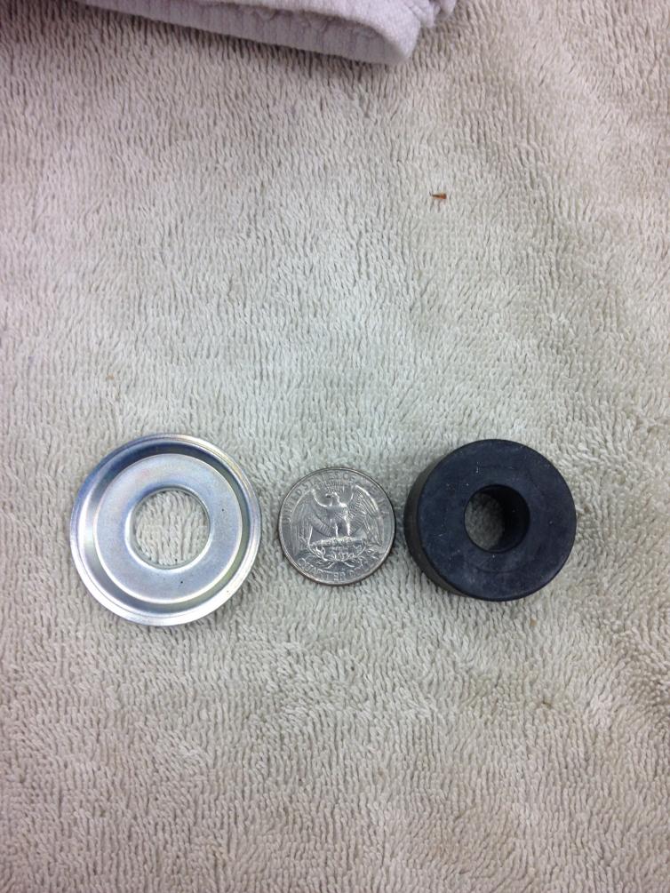

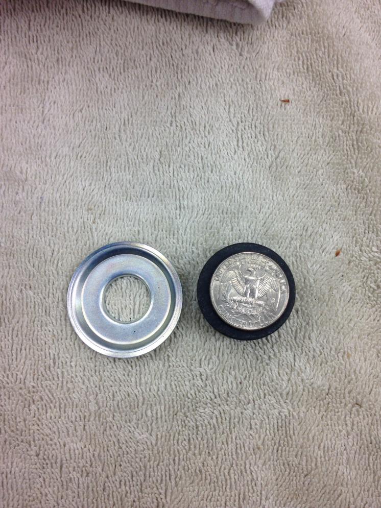

Completed front Shock & Spring replacement this weekend, OEM springs and KYB shocks & KYB strut mount.
Attached photos for reference of parts that came with the KYB Shock (one large rubber bushing, one small rubber bushing, two large metal retainers/washers and one small metal retainer/washer).
Installed as follows with shock assembly inside center of compressed spring:
*Slid black plastic shock cover onto shaft and over top of shock
*Placed large metal retainer/washer on shaft on top of black plastic cover, concave facing up to rest on underside of strut mount rubber.
*Placed new strut mount on top of shock
*Placed large rubber bushing onto top of strut mount assembly.
*Placed the second large metal retainer/washer over rubber bushing and secured with nut.
I did not use the remaining small rubber bushing and corresponding small metal retainer/washer as there was some disagreement as to whether it was needed and/or where it belonged.
One thought was the small rubber bushing and metal retainer/washer should be placed on the shaft of the shock before sliding the black plastic cover over the shock.
What do you guys think.....

I didn't use it. I assumed it was to replace the bushings on the top hat. The replacement tops I used had bushings preinstalled on the bottom.
That was my exact thought as well but seeing that extra bushing sitting there on my work bench made me start to question myself as well as my buddy saying I messed up.

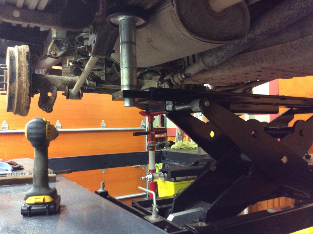

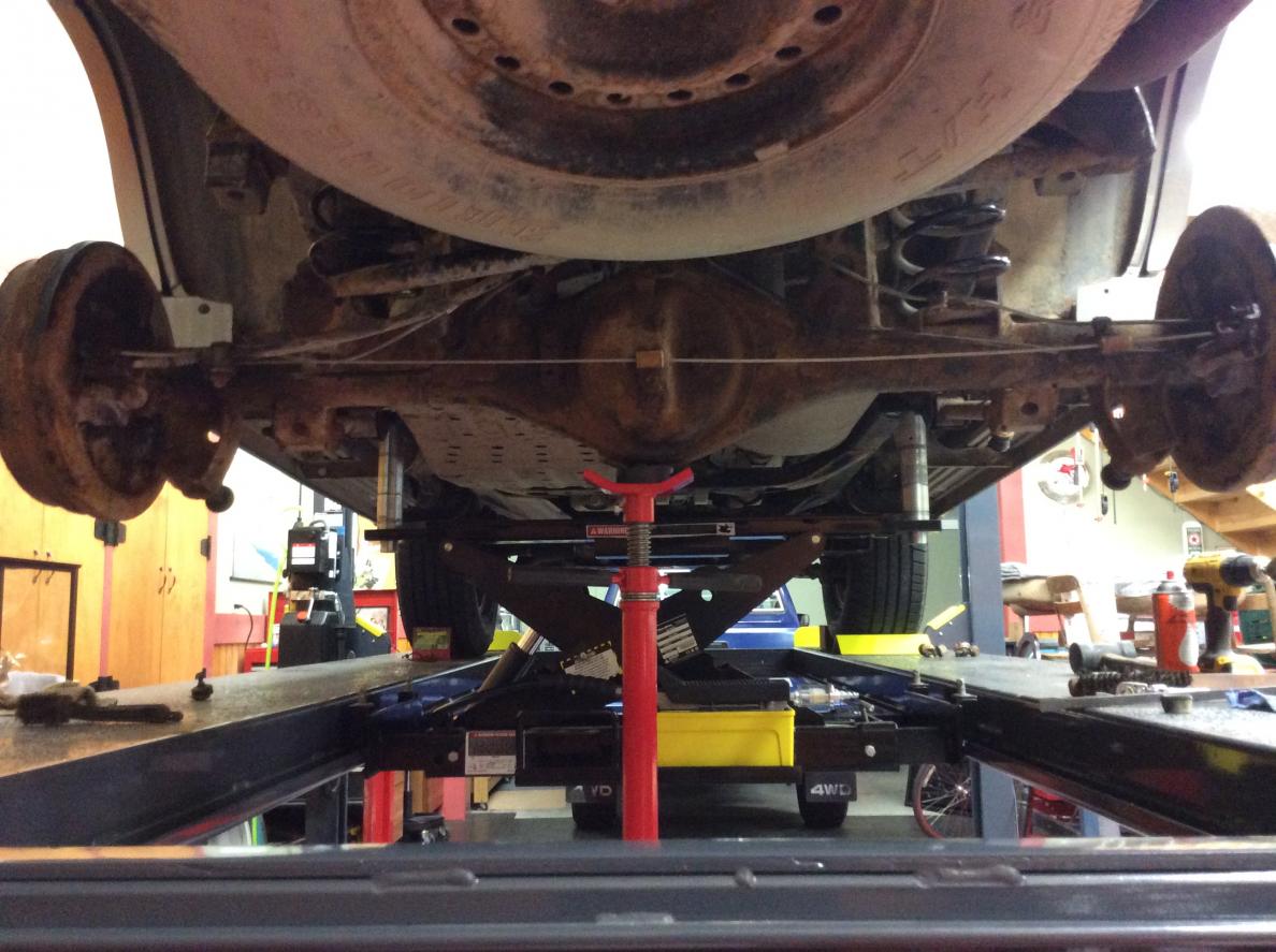

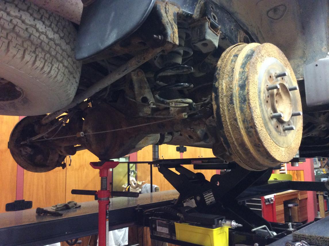

What a difference a day makes!
Back in the garage first thing this morning with a fresh brain.
Got to thinking about Timmy The Tool Man’s video install on front struts/springs and his use of the bottle jack to push down the UBJ to assist in aligning the lower bolt on the front strut.
Took same approach and used the bottle jack to raise one end of the rear differential which in turn lowered the other end enough to pull the each rear spring out one at a time.
45 minutes later with a bit of wiggle and massage had the old ones out and new ones in.
Didn’t want to wait for a helper, just wanted to Get R Done!
