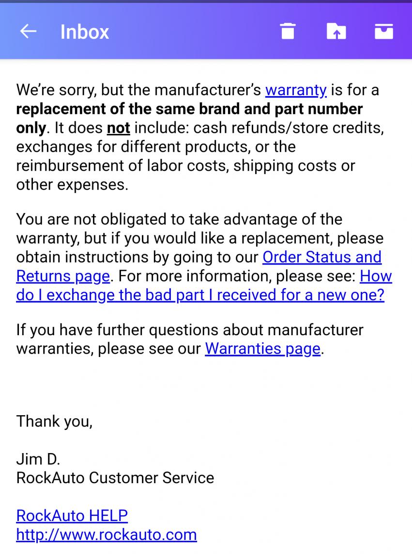

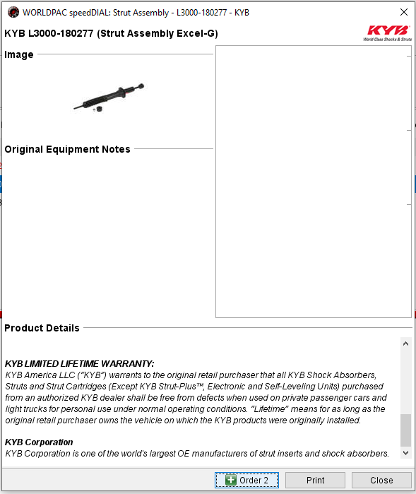

Talk to your supplier, you may be able to get warranty on those.

I can but I will absolutely not install them again.
I also called bilstien and they said the rear 5100 won't work with stock springs so I guess I have to use 4600.
That's fine, just ask them to warranty it and pay the difference for a better shocks. They should accept it, since supplier is not loosing money.
