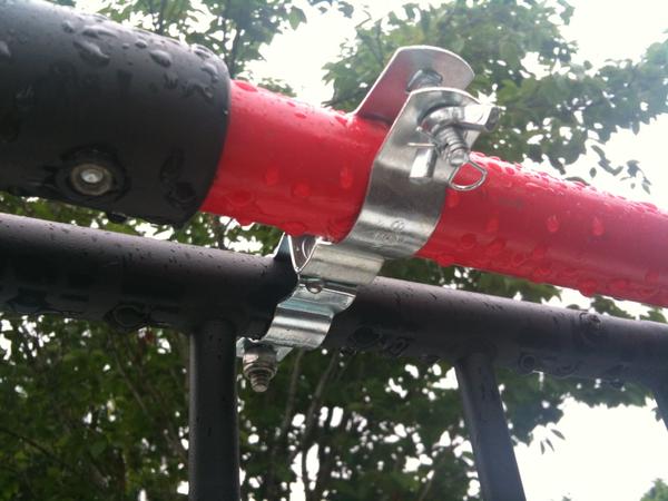

Did a simple setup yesterday in preparation for our trip to Browns Camp today. I had a shovel sitting inside that I needed to get mounted on my rack. The mounts are expensive so I decided to build my own for all of $5. At home depot they have special clamps for mounting up the metal tubes they run electrical wires through. After bolting two together (one that fit my shovel and the other that fit the rack) I bolted down with nylon insert nuts so they won't rattle loose. For the shovel side I used wing nuts. I drilled a hole through the ends of the bolts and put pins through to make sure it wouldn't eventually work itself off. Granted someone could steal it, but it gets the job done. I'll probably spray it down with truck bed liner to make it match the rack. I'm all for the cheap upgrades!
