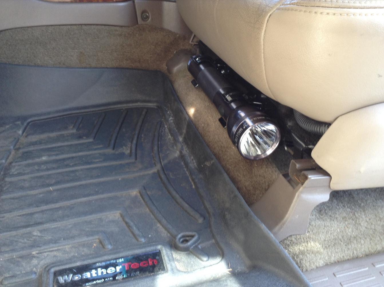

Mag light
Mounted up the mag lite on the drivers side seat rail. Wish the mounts weren't plastic but, we'll see how it holds up.

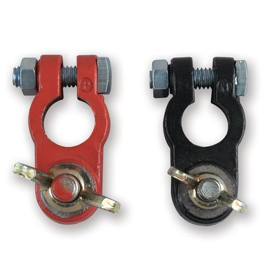

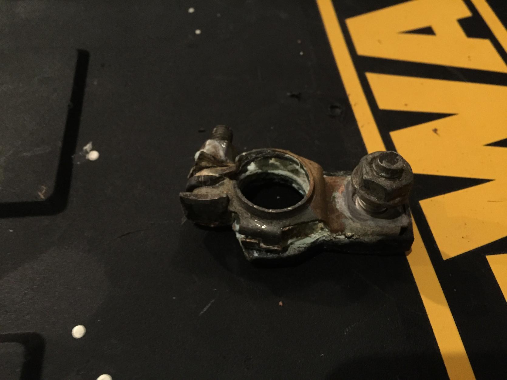

Battery post connectors upgrade
While I'm waiting for a solid 2-3 hours to myself to do my snorkel install, I forgot about a small but important upgrade.
Took the family up to The Summit to do a little sledding.
IMG_5864 by Labrum777, on Flickr
IMG_5217 by Labrum777, on Flickr
Found my way on a forest service road that had a few other 4x4's on it. Pulled a few guys out including a big Dodge 2500 that thought he could flip around on this small snowed in road. Long story short though was my battery post connectors were the OEM stamped sheet metal ones and had corroded so bad that I couldn't get the car to start.
After about 30 minutes, it finally started up and I went straight to the parts store to get it worked out. $10 is a cheap price to pay for peace of mind....

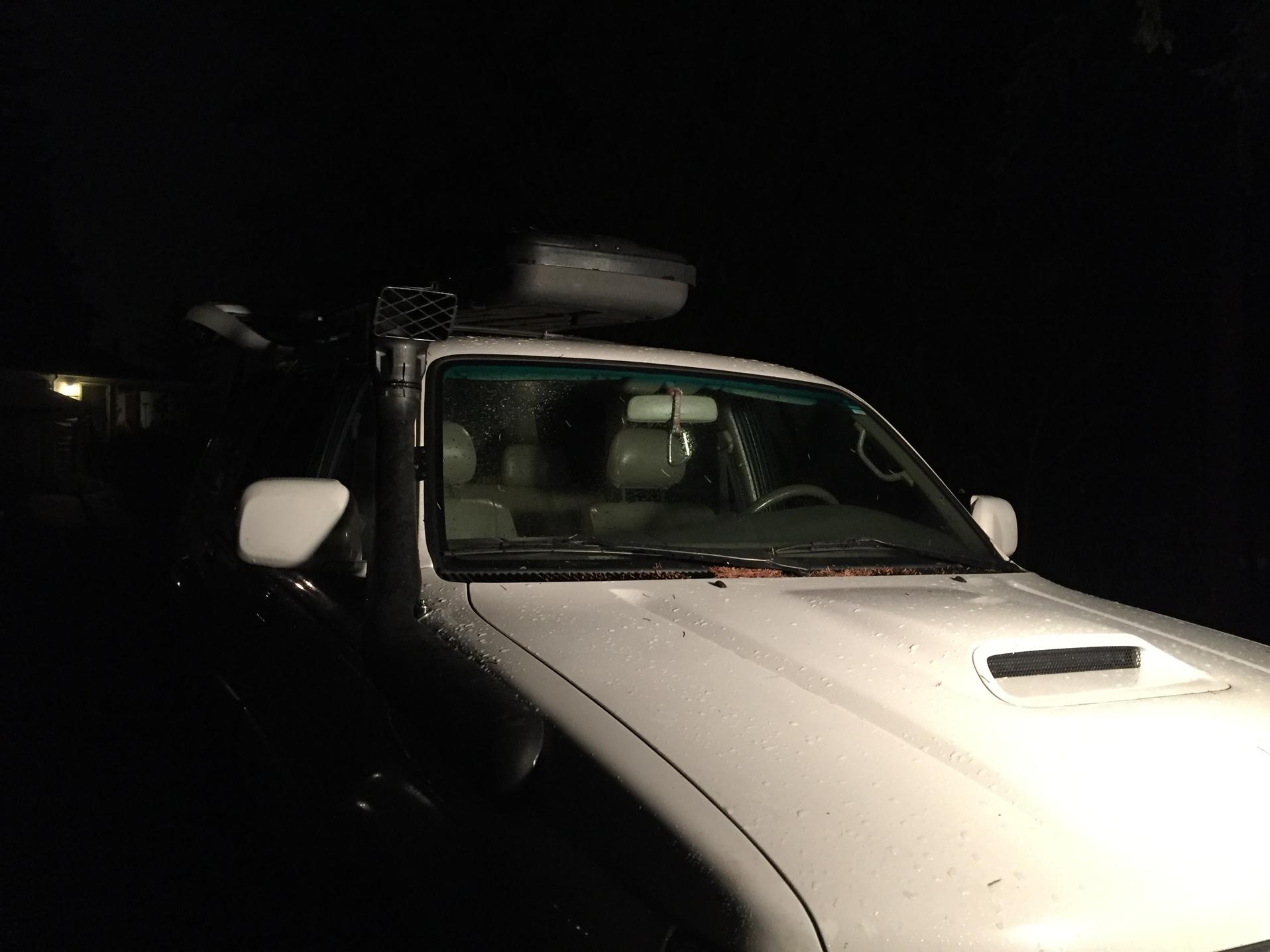

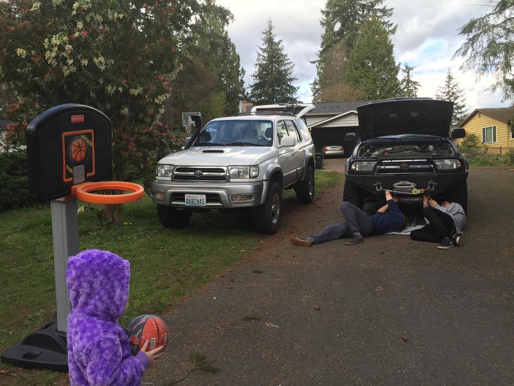

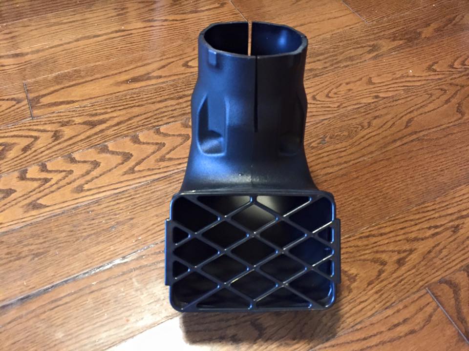

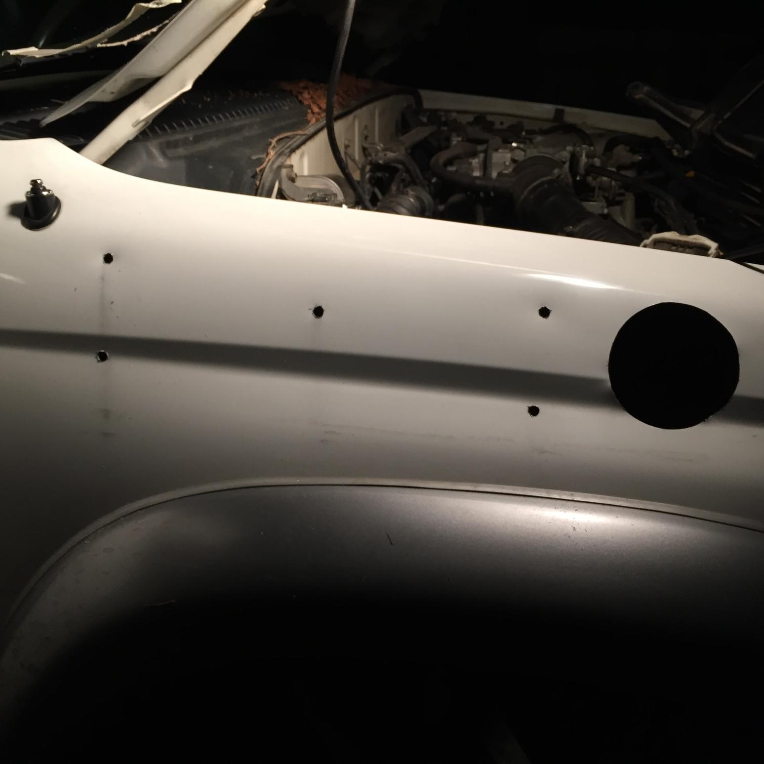

Hilux 167 Snorkel Install
Hilux 167 Snorkel Install:
Thought I'd give some feedback following my install which was the BIGGEST PITA.
At Least the help was cute...
First... I'm fairly mechanically inclined and this project took me WAY longer than I expected. I like to do most of my repairs myself, but make sure you give yourself plenty of time. I ran out of daylight and then it started raining on me :rain:.
• Do yourself a favor and buy some of the plugs they mentioned earlier for the mud shield. You'll need them.
• The 3 5/8 saw hole makes for a really tight fit. You'll likely need to clean the hole out a bit with a regular drill bit for a little more clearance.
• don't be shy about using a little bigger drill bit for the bolt holes. The washers from my amazon kit were huge and the little bigger bolt holes allowed me to maneuver the snorkel easier (and without damage to the threads of the bolts).
• I used a can of spray paint to paint the holes I had made... hopefully to provide a little rust protection. Doesn't have to be pretty... just have a rag handy to snag any drips... it'll all get covered by the snorkel anyways so no need to be perfect.
• For the snorkel attachment on the A-pillar... don't drill your holes for the A-pillar until the snorkel has been fully tightened down to the body of the vehicle. My holes came out about 1/8 of an inch off and the snorkel had to flex a bit to get it mounted. (And definitely use the rivets. For those that haven't used a riveter, keep pumping the riveter until the stem fully snaps off. This is how you know the rivets have secured fully to the sheet metal and snorkel bracket).
• I tried to install the rubber elbow onto the snorkel before feeding it through the fender and that didn't work for me. I had two hangers inside it which made it difficult for it to flex which resulted in having to install the rubber elbow inside the fender like everyone else.
• This was a helpful tip mentioned earlier: **use a long screw driver to pry the end of the snorkel away form the fender so that its easier to slide on the rubber tube.**
• For the rubber piece to the air box... use a little grease or motor oil to lube the end of the rubber. Vice grips on the bottom, a small screw driver, and a boat load of patience finally resulted in it seating properly. An extra set of hands would've helped tremendously, but unfortunately I didn't have that option (or a heat gun for that matter... tried the wife's blow dryer but not sure it helped much).
• Cheapest place to buy the tools was harbor freight for the mandrel ($10), Amazon ($10) for the hole saw and Home Depot for the Riveter ($10)
Thanks to everyone that's contributed to this thread! :beer:

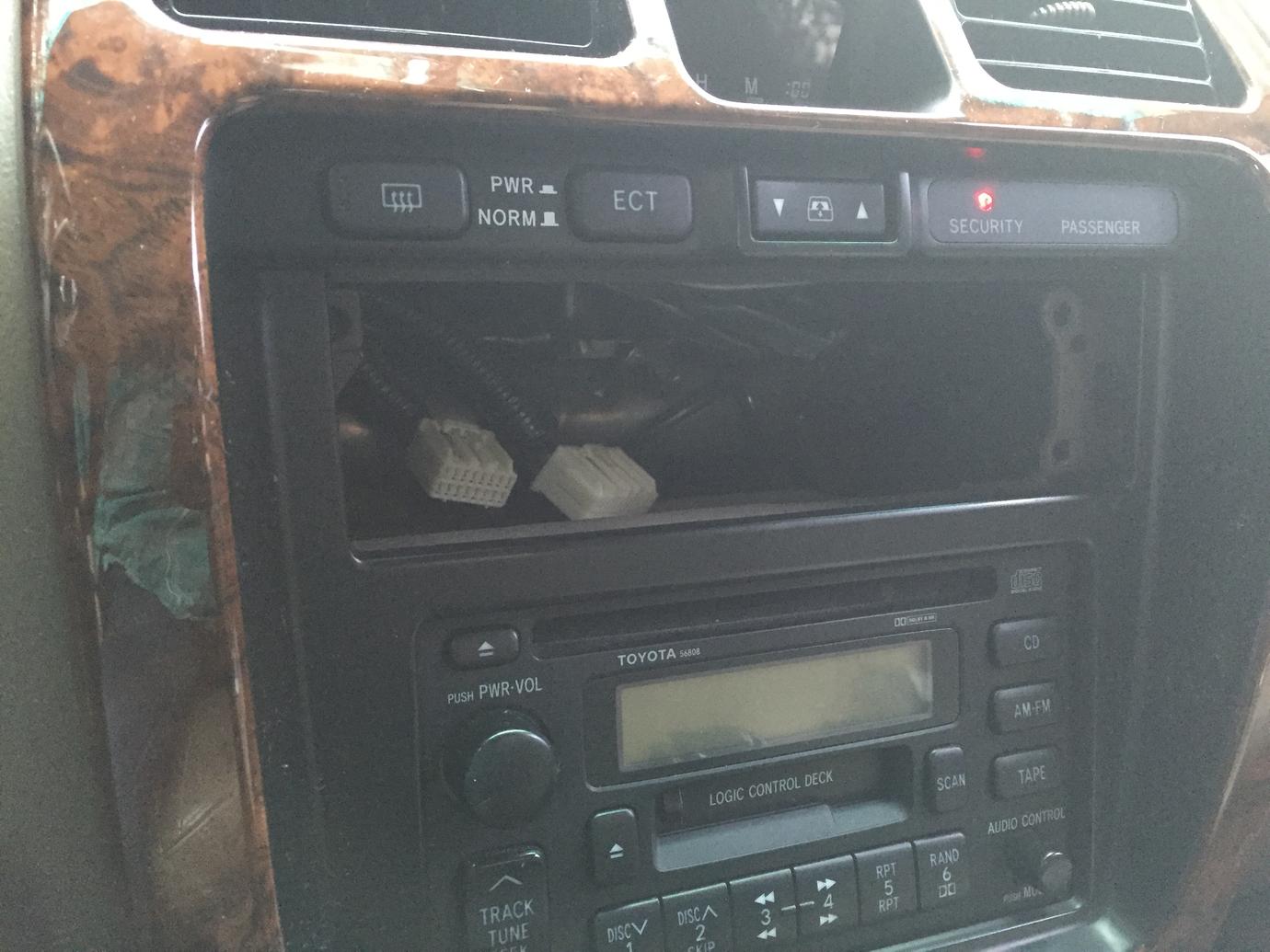

Climate Control
Well, finally pulled the trigger on getting the climate control fixed. I read on a couple other threads that some guys have pulled their's apart and just soldered a couple things and got it working again. I opened my unit up, took one look and said, "nope".
Off it goes to get fixed! Found a guy on ebay that will repair it for $48 which was a steal. He also offered an $11 upgrade for those who wanted LED lights exchanged. I didn't care about changing the color and so I didn't go for that option. I'll give an update once it's back and installed.

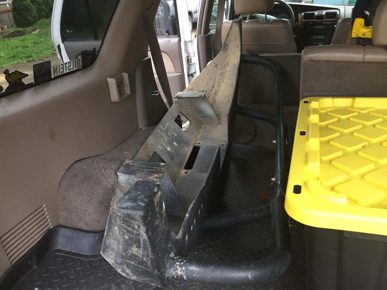

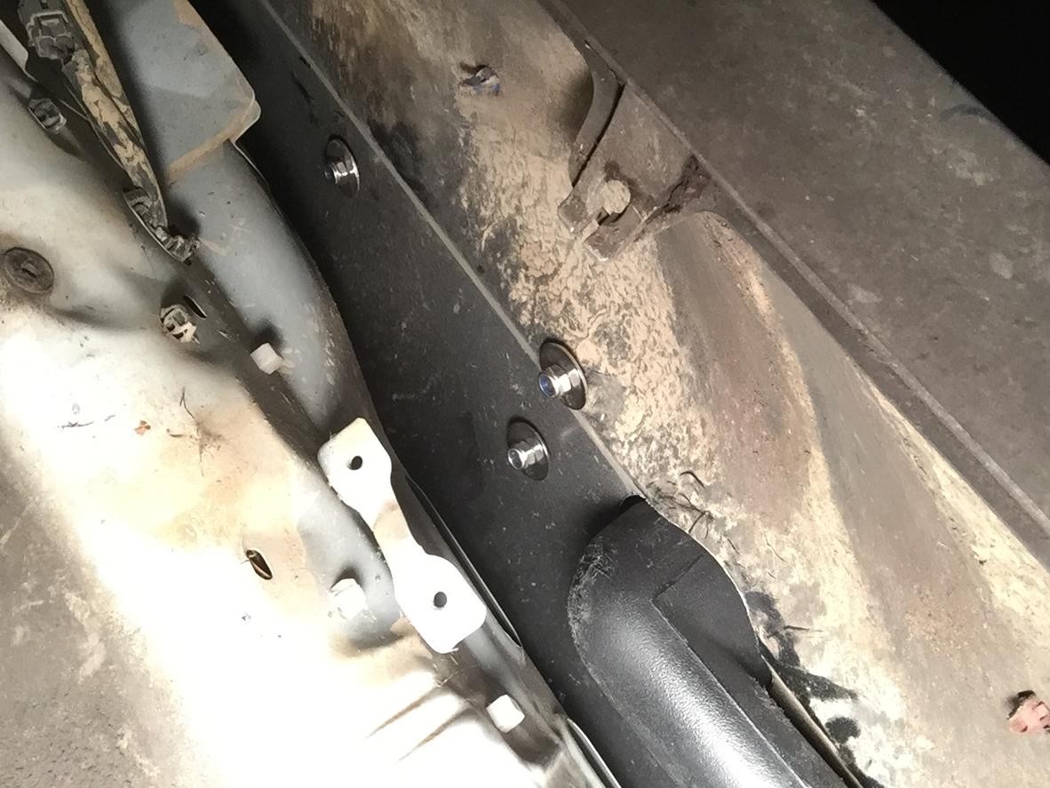

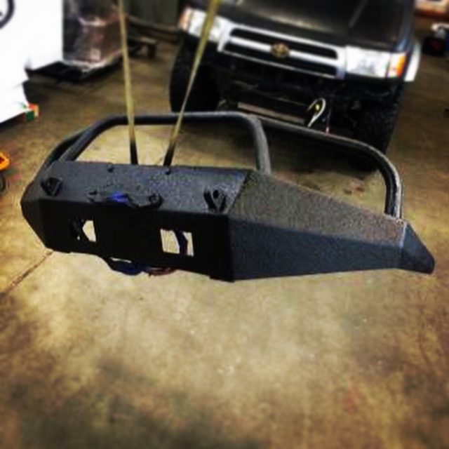

Plate Winch Bumper
Well, it finally happened. I found a plate bumper on craigslist for a really good deal that I couldn't pass up. Here she sits...
I'll post up more pics once I have it mounted. I've got some cutting and welding that needs to happen first.
Is that one of those NWTI bumpers that's always on craigslist?
No... this one is a little different. NWTI always has their little logo cutout - but then again, probably something similar. Looks and feels like an ARB - very solid build. I also can't remember if you have to modify your bumper rails for the NWTI bumpers but for this one, I do. Can't wait to get this thing mounted!

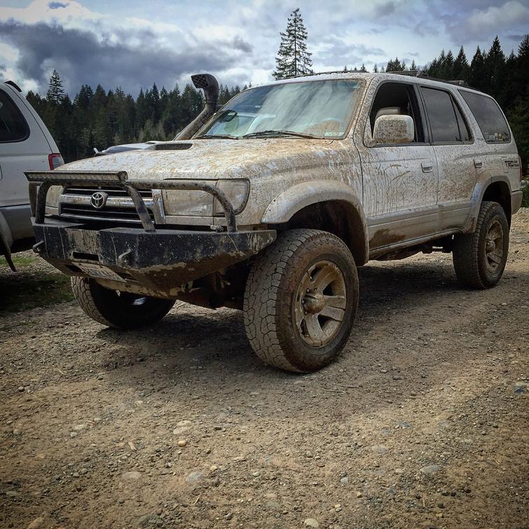

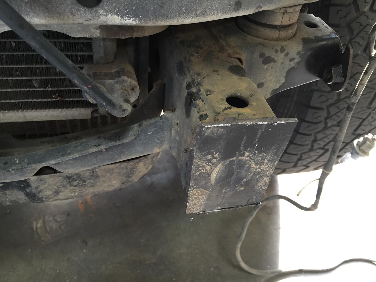

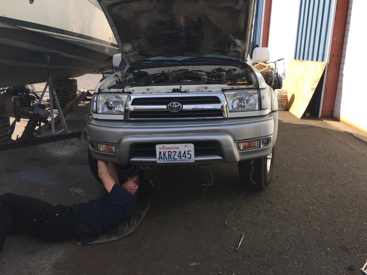

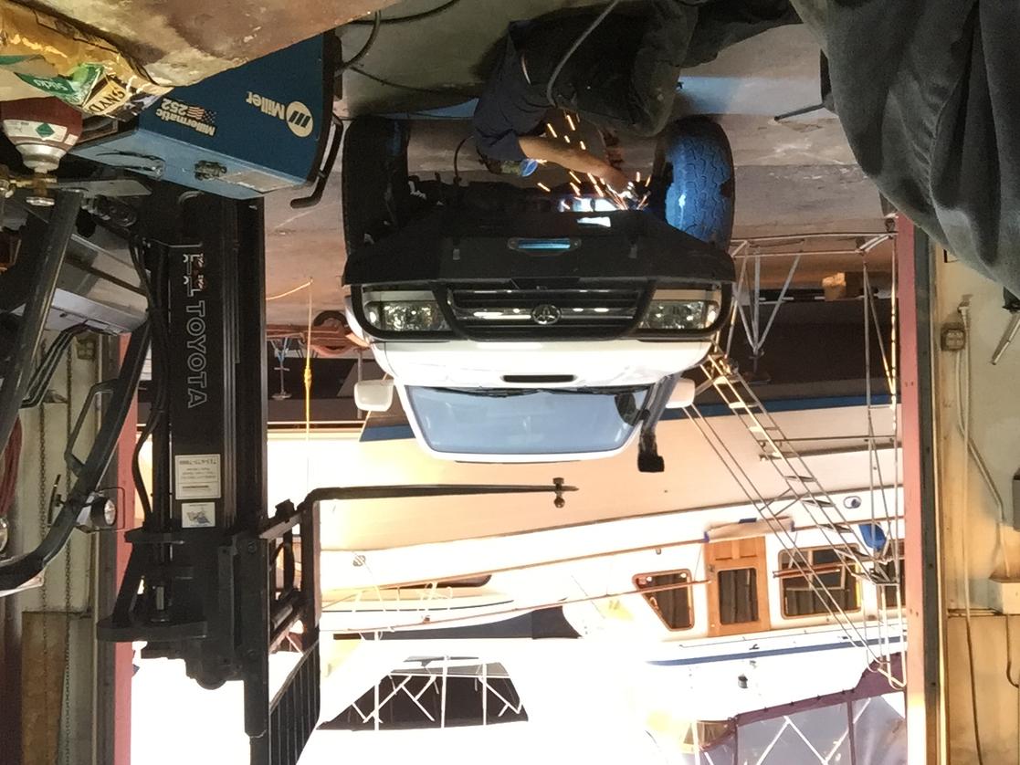

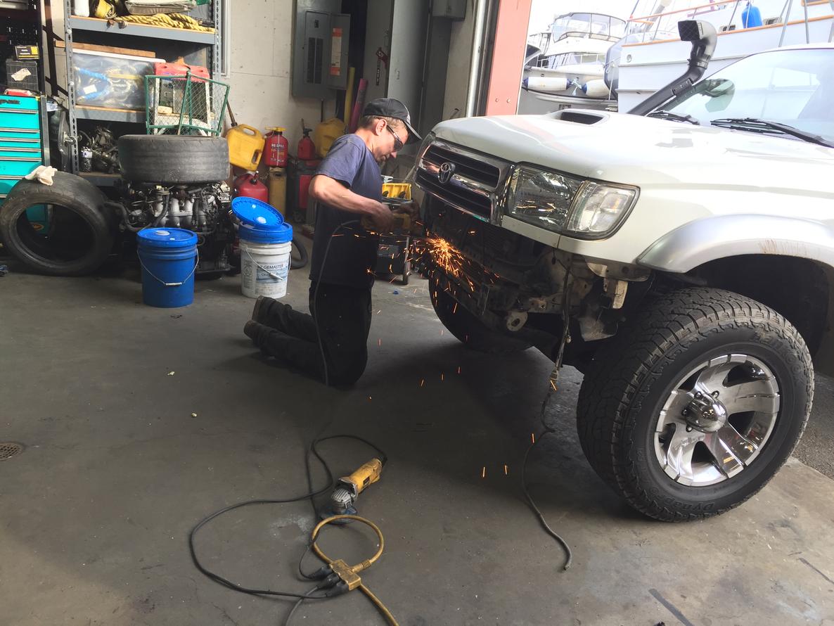

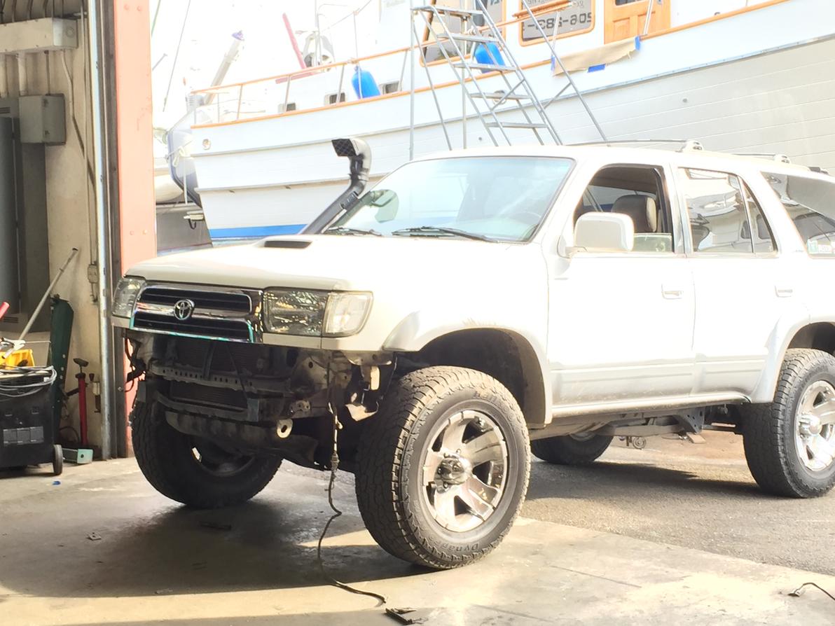

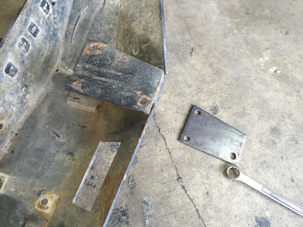

Bumper Installed
Well, finally got the bumper installed. Took about 4 hours... the guy I bought it from was super cool about the doing the install for me. Amazing what having a shop with all the right tools can do for you.
