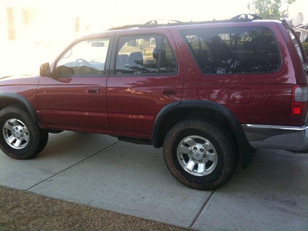

I hope to get an ARB front bumper....one day. Not sure when that will happen but it's in the idea realm. Should I go ahead and get the medium coils instead of the regular one? Also, if I get the medium coils in the rear (Hopefully so I don't sag under load), will that drastically hurt the ride quality?
Also, with the front spacer plate..I will sit level? The main thing I fear is doing a lift and STILL having rear sag.
Finally, I have 267/75 tires. Will my car look silly?
Here's a picture for notes.
Thanks!

If you go with medium coils you shouldn't need a spacer plate.. If you're going with the softer coils you will. meduim coils will ride stiffer.
You will still have very slight sag when the rear coils break in. I do believe toytec sells some rear coil spacers to help with this problem that I may use myself.
I don't think it would be that bad looking
yes i would recommend going with the medium coils up front if you are planning on getting the ARB. in the meantime, yeah the ride will be a bit rougher than the standard ones but its not going to be a horrible ride. i would still go with those because there is more of a chance that the front will sag when you put the bumper on if you stick with the s****ard coils.
as for the rear, the OME either the 890's or the 891's will work fine. i think that the 891's will have less of a chance of sagging and you can carry more weight too. however, the 891's obviously will be a bit rougher. both the 890 and the 891 area a 3 inch spring but most people have said that you get a 1/2 inch more with the 891. i would recommend going with the 891's if you really don't want sag

nice runner BTW :cheers:
Thanks! I've had the window's tinted since the picture. My drive way has a downhill slant so you can't see the rear sag.
