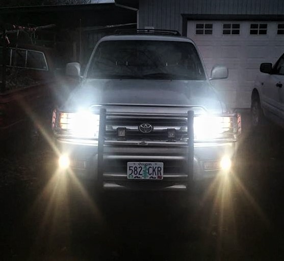

I plucked mine from the wrecking yard and they were aimed perfectly when I installed them – so I can't rightly say one way or the other.
I just installed some PIAA 10704 H4 Night Techs (here on Amazon), and they are perfect for what I'm wanting. They are very bright, supposedly long lasting, and most importantly, NOT BLUE.
