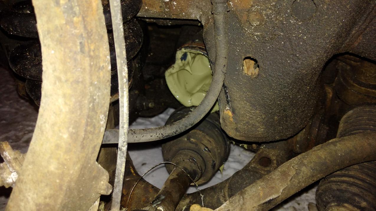

So I experienced my first LBJ failure today on the way home from school and was it ever scary. Will see if I can get a new one tomorrow but my CV has me confused. Do I need a new one?
Sorry for the bad picture just got home from work and it's past midnight and -30*C.

Minimum you'll need a new boot kit. I think you'll have to clean things up and see how it looks. I'm curious to see what the answer is.
Did you have any other damage? That's pretty cold for wrenching.
NO, your CV is OK. You may need a rubber boot if it is torn. Just reinsert your CV back in.
Also get CV axle grease.
Buy a OEM LBJ and nothing else.
I'll give it a clean tomorrow after class. Really hope someone in town has a LBJ in stock. Is that yellow gunk just grease? Is the grease called CV axle grease? And the boot doesnt appear to be torn. I might have to get a new fastener though. Luckily there's an auto club on the base here that I will get it towed to if there's an lbj in stock. Way too cold to wrench ha
