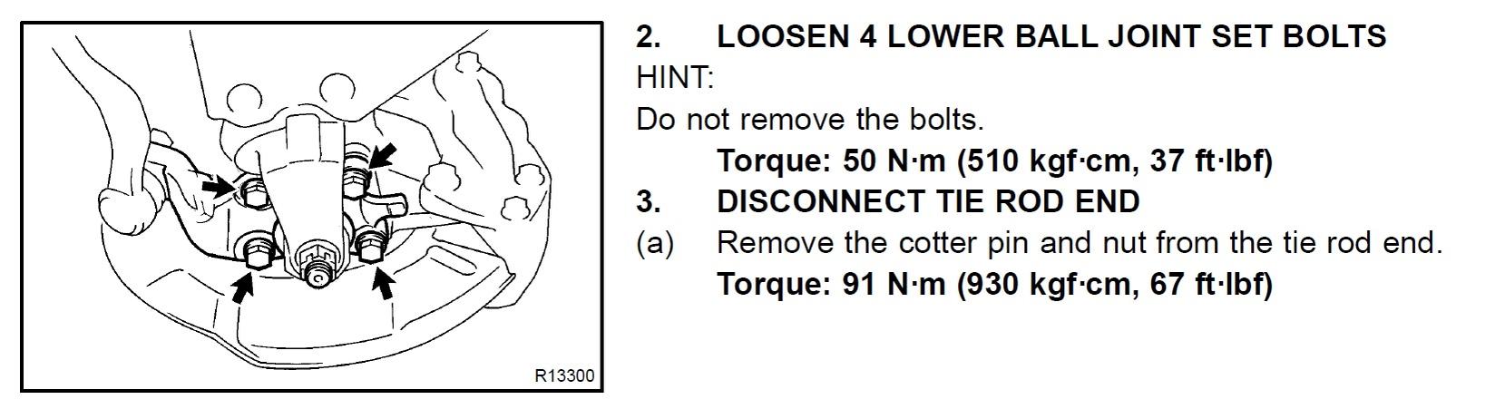

Those bolts aren't very big and I think almost 60 ft lbs is too much. The manual calls for 37 although there are discrepancies in some manuals.
Personally, for that size bolt I think 37 ft lbs and locktite is all you need.
Actually, I agree. I might even go as high as 40 ;) 59 just seems too high.

I believe the 37ft/lb torque is for 2002 only, or at least that is what is found in that year's FSM. Every other 3rd gen year is 59ft/lb.
