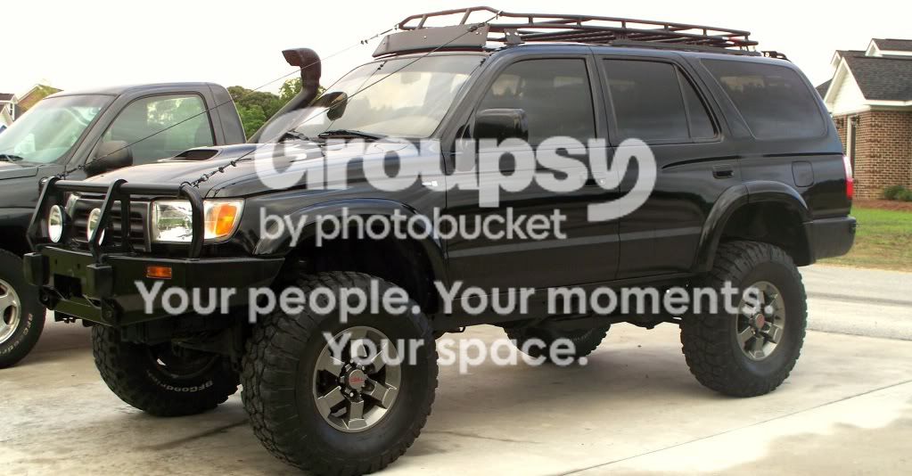

Thanks. Any pics?
One set or the other is going to end up for sale once I make up my mind.
100_0493.jpg~original
Looks good! Don't see much rake there. What was the lift on the front. And how much weight was in the back?
It'll be interesting to install both spring on the same truck and take measurements.
