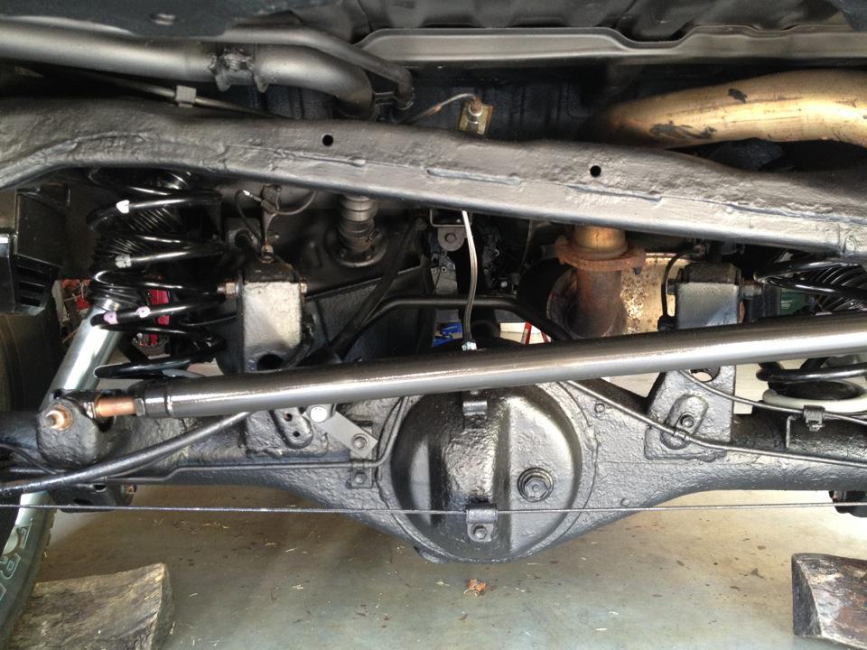

I had double purple grey whites for a while. Technically they are double pink grey white as per the lift sticky but they sure looked purple to me. Do they look like this? Sorry for the pic. Its the only one I have showing the color code.
If so then yes these are 7.5 wraps.
The other ones could be a green yellow white. That would make them an 8.25 wrap and they would measure 19.5". The colors on these coils seem to be more like "could be pink" instead of "pink".

I might be telling you info you already have but mine are slightly different than the FAQs
FAQs state:
19.25" Double Purple Dark Blue White 8 wraps
19" Double Pink Light Blue White 7.5 wraps
Mine are off a 94 and are
18 7/8" Double Purple Dark Blue White 8 wraps (measured very accurately)
18" Double Pink Light Blue White 7.5 wraps (measured very accurately)
I think the double colors as described as pink and purple are the same color. The info in the FAQs is a collection of data from different forum members with a possibility of one member saying the color is pink with the other saying it is purple.
I'm saying this because one of your springs appears to be in the FAQs labeled as a "Double pink, grey, white. Although I don't see anything that could be interpreted as a Green, Orange, White.
Edit*** As TC Mach stated above. Your Green, Orange, White are probably the Green, Yellow, White.
