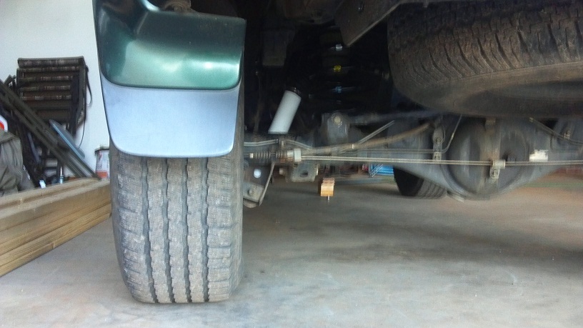

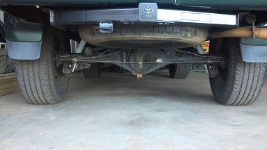

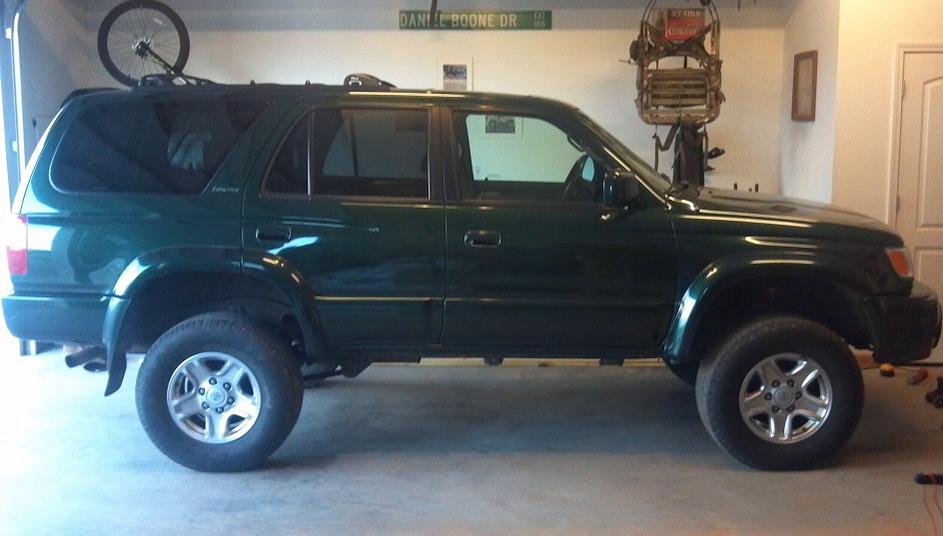

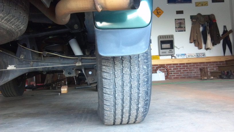

Toyogus, can you post a few pictures of where the rear axel is sitting in respect to the body? Probably the easiest way would be to take pictures of where the tires sit beneath the wheel wells. Im asking cause I have a set of lc 7.75 wraps on the way now. By the way you may already know this, but the easiest way to decrease the photo size is by opening in paint, then resizing with the resize icon on the top left
here is the backside of the runner, the axle may be shifted a tad.
