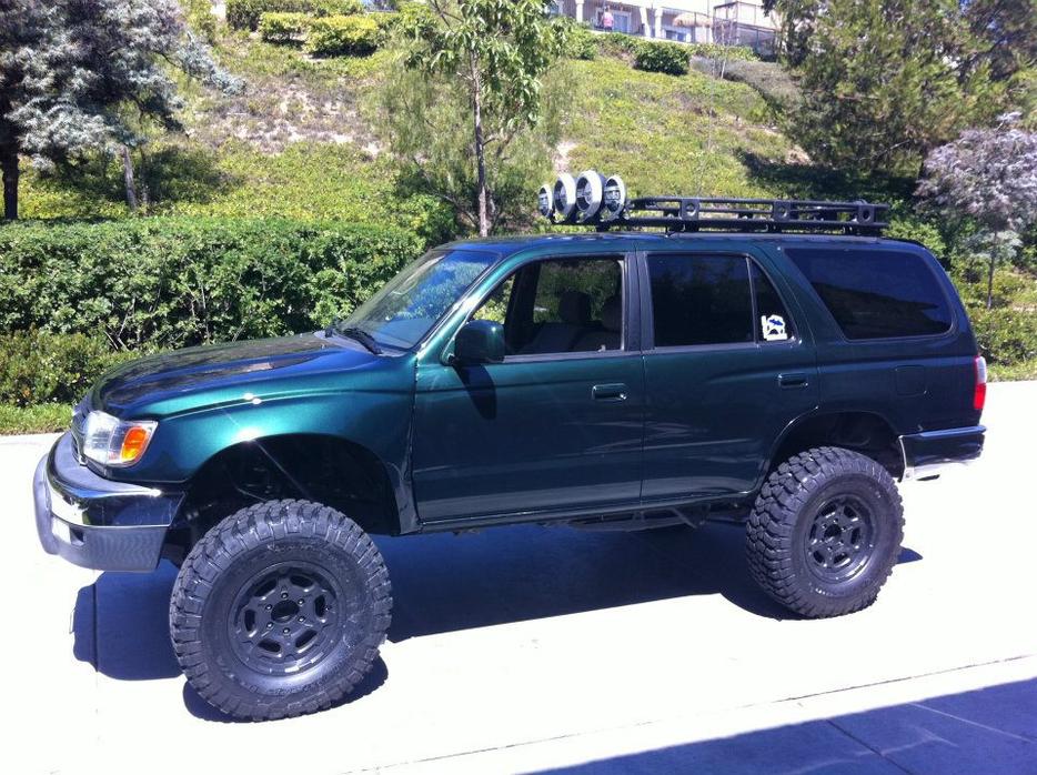

Don't know if this will help or not, but here is a pick of my truck.
I have the Sonoran Steel 1.2A rear kit with LC coils. not sure how many wraps though. I didn't really pay attention when I installed it. And TC long travel up front.
Oh, and 285/75/16 KM2
