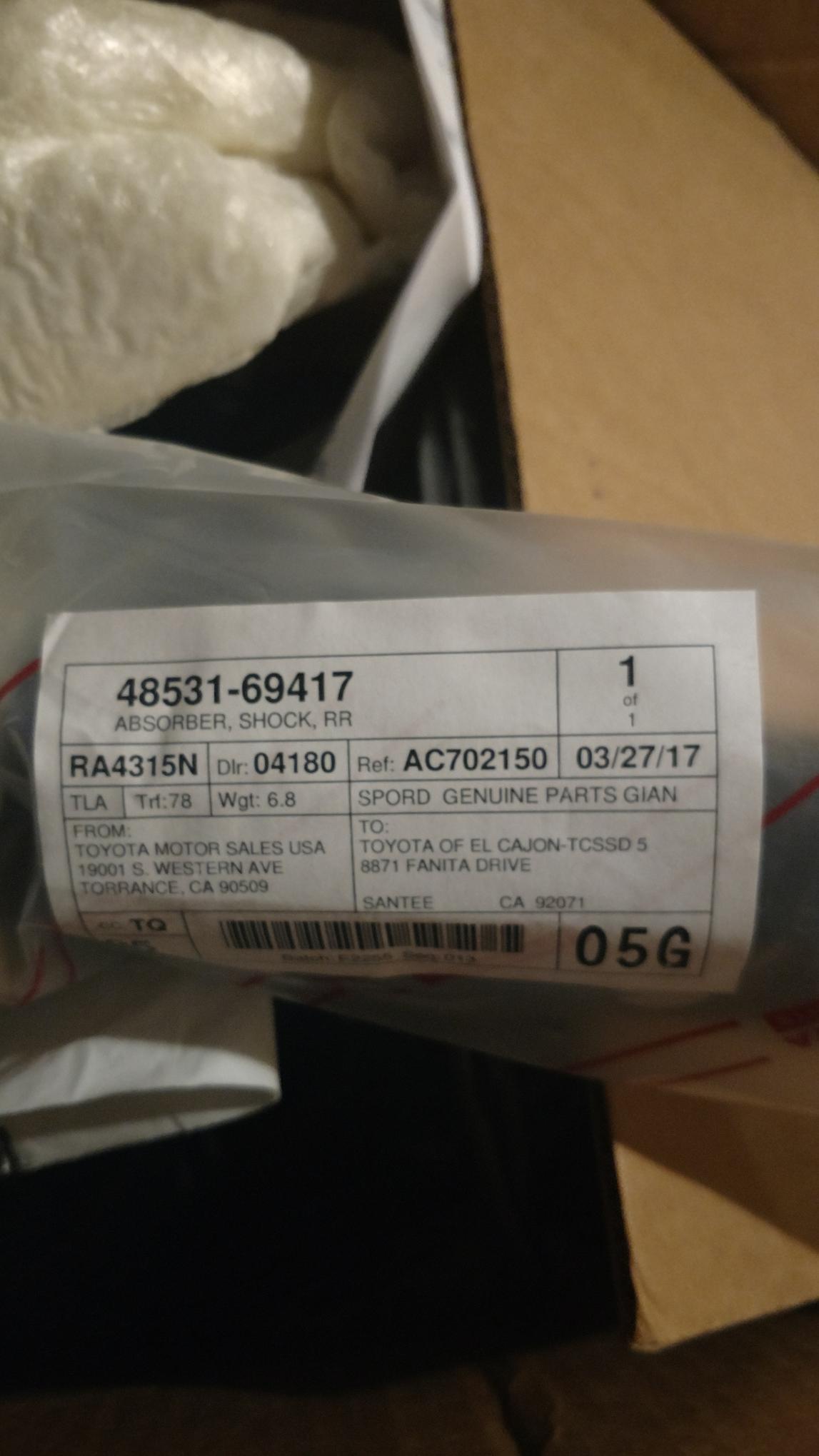

Just ordered some LC80 front springs for my gen3 surf. What shocks do I use LC80 fronts or rears? they are both the same price £95 a pair delivered for nitro gas.
Thanks in advance Dave
The question zwalker16 is which LC shocks, front or rear.
The answer is rear LC shocks. Front LC shocks do not use the stud type upper mount needed for the rear of a 3rd gen 4Runner.
Rear LC shocks for the 4runner LC coil lift.
