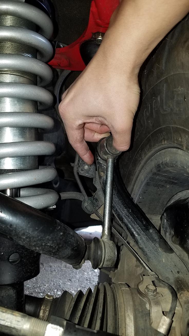

I also had an intermittent "pop" noise coming from my front suspension. It was seldom but when heard, it was while I was turning the wheels, flexing on a curb or turning into an incline driveway. Thought it was the LCA bushings being toast but turned out to be both endlinks being shot They looked and felt fine when they were on the vehicle but after a bit of wiggling they turned out to be the culprit. Removed the sway bar and no more noises.
I made a thread about the popping noise I had.

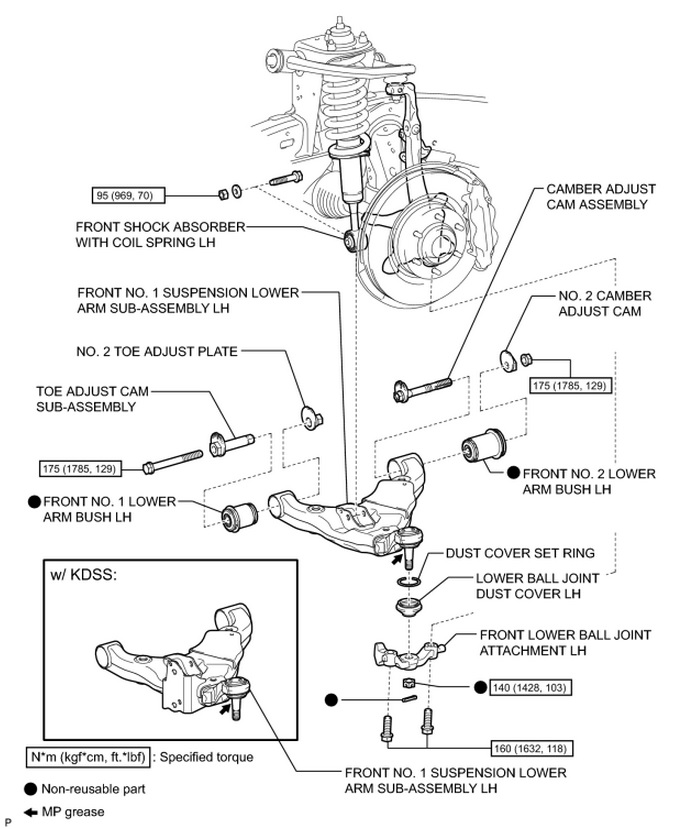

The Toyota manual calls for 129ft/lbs for the 4WD version. If you tightened the LCA bolts and the noise is still there I would completely remove the sway bar next and see if that makes the noise go away.
Have you tried wiggling the endlinks with a bit of force while they are on the spindle? Any noise or grease from the boot? My links looked good but after a bit of wiggling a crap load of grease spilled out. Installed two new oem links and it eliminated the noise for me.
Thanks for posting the values. I was getting the occasional pop when starting or stopping the vehicle.
Post alignment I think the shop didn't set them back to factory. I brought them back to 129ft/lbs and the problem seems to have gone away.
