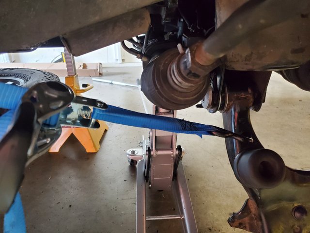

Thank Christ! Got them in with a little love... and a ratchet strap, lol.
