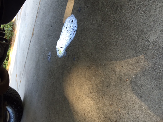

here is a pic

That looks like more fluid than it actually is. I still wouldn't put any unnecessary miles on it until it's fixed though.
It's hard to get a good feel for where that fluid is coming from in that picture. You might want to crawl under there and take a look. If it's differential fluid from a bad seal you will trace the leak back to where your new CV Axle dissapears into the front differential. It will usually drip onto the skid plate, pool there, then leak off in a place that makes it hard to really tell where it's coming from.
Since you didn't notice the leak until you engaged the 4WD you might want to make sure that it's not your transfer case that's leaking. It would be the same kind of fluid but leaking from a different place. My bet is still on the axle seal but it'll be obvious if you get under there with a flashlight.
It is coming from where the axle goes into differential. And yes it has fallen on skid plate and leaked off of that
And that pic was taken after car had been moved and then parked again so not necessarily aligned from original droppings
