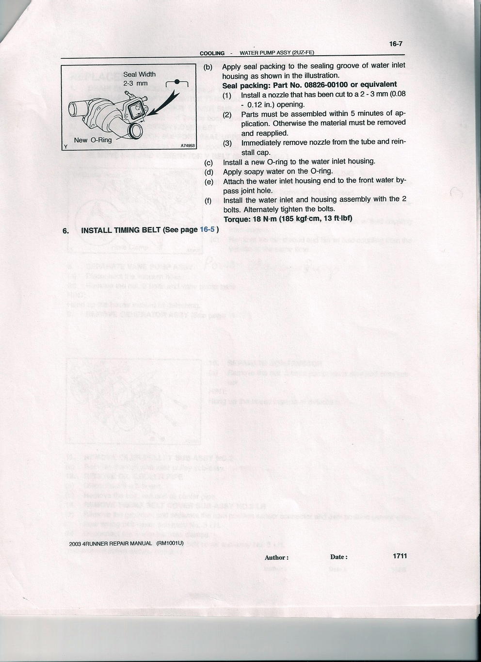

The pic attached is from the service manual showing the rectangular face that gets RTV. The manual calls it seal packing, I assume that is RTV.
03_4x4Runner,
You gave me a different P/N than what the manual calls for. Any idea if there is a difference?
