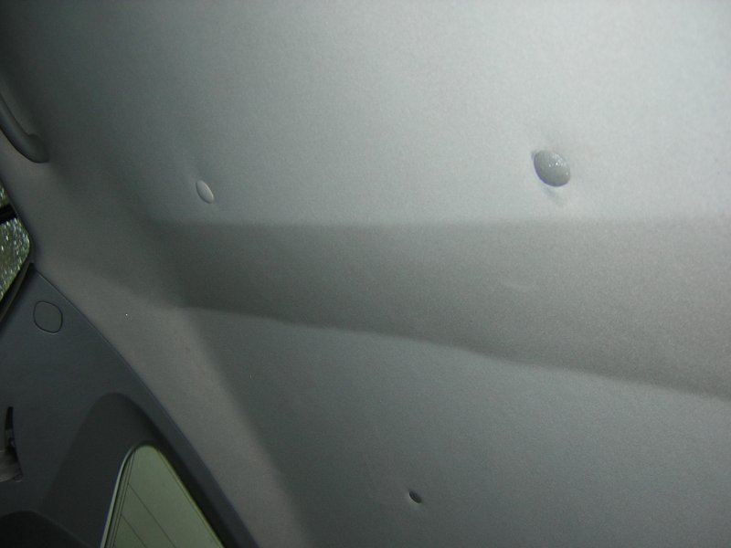

2005 4Runner Sport. I think it has an after-market sunroof, although as I bought the car used I'm not entirely sure. A manual for it came with the vehicle.
It's been raining here, and I just noticed that the rear sear on the driver's side is wet. I looked up, and the felt/cloth "bolt" that appears to keep the ceiling fabric connect to the ceiling is soaked. so much so that it looks like it's dripping onto the seat.
The thing is this: The "bolt" on the other side is not wet at all, and the ceiling cloth near the wet bolt doesn't feel wet. Ther appears to be no staining on the ceiling indicative of past wetness.
The roof on the exterior of the truck appears fine. The seals around the sunroof appear fine. I haven't left the sunroof open.
Has anyone seen or heard of this? Is there any way I can access the roof or ceiling? Do these bolts pop out?
I have a number of rattles up there that I'd like to check out, so those last questions have been on my mind for a while.
Any help is greatly appreciated!
thanks
RPM

Follow-up.
I bought a day's access at techinfo.toyota.com and looked at a lot of the repair manuals that dealt with the headliner and sunroofs.
I'm still not sure what's going on...unless the rear drip channel is clogged. I'm not able to see the opening of it unless I take the whole headliner down. I'm not sure I really want to do that.
That clip in the above picture was still wet today, and I yanked out. I expected water to drip out, but none did.
I'm at a loss. I suppose the next step would be to find an aftermarket sunroof installer and have him take a look.
