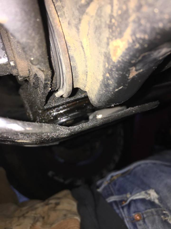

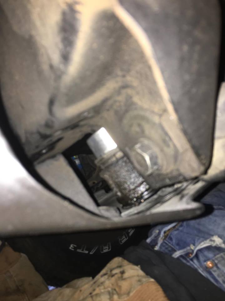

Unfortunately I did this last week while I was still back home and was too busy to post about it until now so I can't get fresh pics of how the boots are looking or anything. I only have this not very good picture of part of the front diff when my friend and I were adjusting the skid plate. You can sort of see what I'm talking about.
As for rebooting or buying new axles, does anyone know the general life span of a cv axle compared to rebooting the oem or buying a new set? Thanks

That looks too thin to be CV grease from a torn boot. Also a CV leak would not be that deep inside and would spin out globs of grease vs dripping oil. It's likely your front diff axle seal leaking, of which you need to pull the CV axle to replace.
I agree. That looks too thin to be CV axle grease. OP, pull your front skid and get a good look at things. Finding the origin of a leak can be difficult but there's some basics to follow. First look where the oil is dripping down from and then let your eyes travel above that area looking for where it could be originating from. The fluid could be dripping down from somewhere way up above and through the path it takes getting to the ground, it may not be exactly above where it's dripping from. So, you look up until you don't see an accumulation of oil/grease anymore and now you have your search field to inspect further.
If you can't see an obvious source of the leak, degrease the area so you have an easier time locating it as it leaks more. You should definitely check your front differential oil level. Beware, the fill and drain plugs that Toyota used are f*cking stupid. They decided to use a 10mm allen bolt instead of a regular big hex head bolt head. And, these plugs are known to be really stuck in there especially if the gear oil hasn't been renewed in a long, long time or ever. Since they can really be welded in there, they are prone to strip like happened to me and many others. You need a 10mm allen socket and most likely a decent size breaker bar. When you get the fill plug out, dip your finger inside the hole and see if you can touch gear oil. If you can't, you're low and should top it off. Good luck!
This is very valid point before starting to tear into things and throwing new parts at it. Definitely need to clean it up and isolate the source. From the picture, I'm assuming this is the driver's side and a leak that pools to this area could be many things:
1. Front diff axle seal. Unless this is a severe leak, checking the diff level might not reveal anything.
2. Power steering rack leak (input shaft)
3. Coolant leak from the oil pump cooler rubber lines
4. Oil pan
