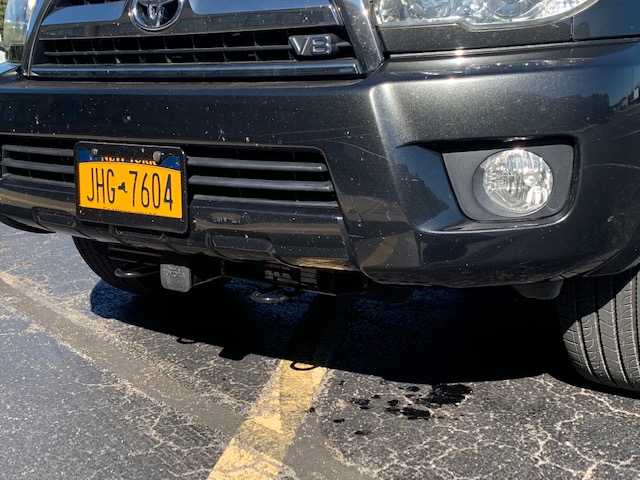

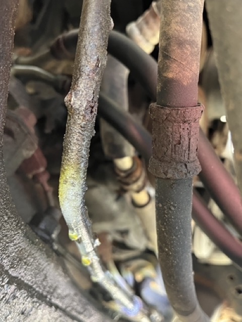

Hi everyone, I'm not overly mechanical, but I like to try to do my own repairs when it is possible and reasonable. 2008 4R Sport V8, I noticed last week the power steering reservoir was empty so I filled it up. I then noticed a day or two later it was empty again. I filled it up, parked it on some blacktop and within a few hours noticed the leak (see pic). Whether it's actually leaking from the driver's side or is running down somewhere I am not sure. Two questions:
1. Any typical troubleshooting or repairs that I should try and are they do-able by me in my driveway with basic tools?
2. I had the timing belt service done a few weeks ago by a trusted independent shop, there's a strong chance the PS fluid has been leaking forever and I just didn't notice, but is there any plausible chance the leak was caused by the timing belt service?

Where that's dripping at it's almost got to be the ps pump or a line. The rack and pinion would be much further towards the firewall or passenger compartment. Basically, you just need good lighting, good eyes and maybe a good mirror. At the rate it's leaking though you may need to get some brake cleaner and clean off the excess fluid and run it some to be able to tell where it's coming from. As far as the shop who did the timing belt... I haven't done a timing belt on one of these so I'm not sure how much contact they would've had to have with it. If it was just a few weeks ago, this is what I would do. I would take it back to them and ask them to take a look at it. Be totally honest. Tell them you don't think it was leaking before but you're not certain. I wouldn't use an accusing tone. If they're honest they'll correct it if it's their fault. As I see it there are three possibilities:
1. Coincidence. It just happened to start leaking a short while after their repair.
2. They disturbed it; loosened a line or something and caused it to begin leaking.
3. It was leaking before you ever took it there. If this turns out to be the case I think I'd be more upset with them than if they accidentally caused it. That's because they didn't bother to tell me about it and give me the option to have it fixed while the car was there. And if I was the shop owner I'd be mad at my employees if they lost a potential sale like that. (I'm a former shop owner)
It could also be transmission fluid. Take it back. No such thing as coincidences after having a repair shop work on your car.
I have to respectfully disagree with you. He knows it's P/S fluid because he's had to refill it twice already. And as a former shop owner I know all too well that coincidences do happen. They were one of my least favorite things when I had my shop. I've corrected plenty of them for free just to keep a good customer happy. But I do agree that he should take it back to the shop.
I just replaced the low pressure line. It was about $30. Toughest part was getting my seized skid plate off. Pop the hood and look down and trace the thinner line off the ps reservoir and then try to get underneath. It to see where it’s all wet. Also make sure everything is snug, if they removed stuff to get to your timing belt, something may have not been placed back securely.

Please update this thread with your findings. The PS steel lines rust like crazy on these and many have had to replace the high pressure line because they eventually leak. If it’s either one, you should just have them replace both so you don’t have to go through this again.

Minor update, don't have the official invoice so I can't provide any additional detail since parts won't be in until tomorrow. BUT...
1 P/S line was rusted through and leaking
2x transmission lines were rusted through and leaking
This makes sense since my P/S reservoir was depleting, but at the same time, when I touched the fluid on the blacktop it was red-ish in color. There is significant rust under the vehicle, so this didn't surprise me at all.
I asked them to take a very good look at the other lines because I would like to replace others at the same time if necessary. They took a second look and said while others had rust, they didn't think they were beyond 50%, so they would not recommend spending the money now but they can keep an eye on them over time. They said other shops may tell me to replace them all, but if it was their own vehicle, they would only replace the 3 total lines right now.
Rough #s were about $180 for all 3 lines, then $100ish for labor. Planning for the work to be done on Wednesday when the parts are in, so we'll see what evolves!

That seems like a very fair price. I’d pay that in a heartbeat not to have to mess with it! Old, rusted lines can be a real bear to deal with, especially when the fittings are rusted together. Sometimes the wrong fitting shears off, and you have to replace a part you didn’t intend to!

Its a good thing you had it looked. Since there is no transmission dipstick, you might have run low on ATF and caused damage to the tranny.

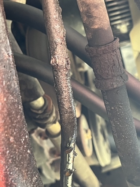

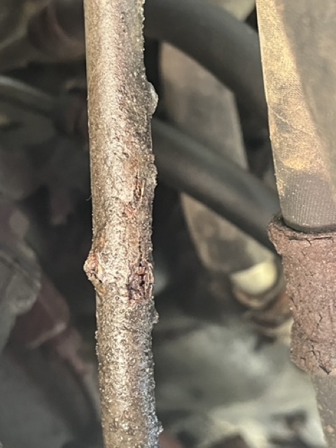

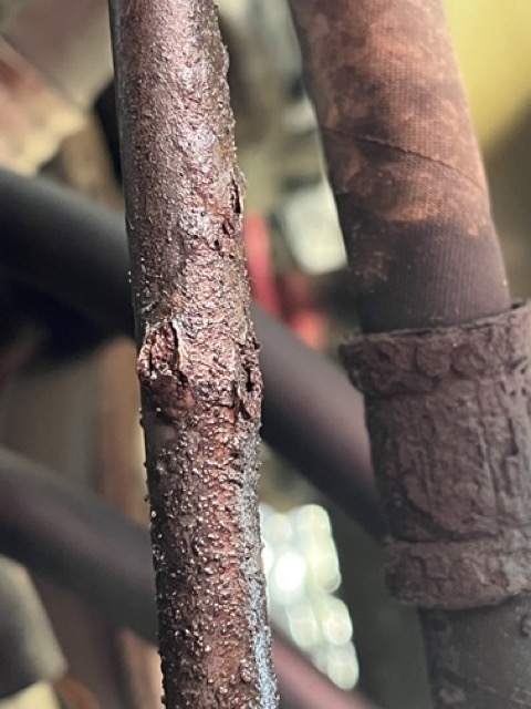

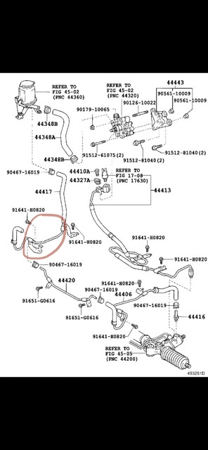

similar issue. any input appreciated
2008 with rust in Michigan. power steering fluid disappearing recently. I think I found the source of the leak. anybody have any experience replacing any of these lines? not overly mechanical but open to trying to replace it. stupid question...is wrapping this with some electrical tape and seeing how it holds up completely inappropriate for temporary fix? these pictures are all the same location just different angles.
Tape will not work on this thing, not worth trying. As mentioned on the other post, cut back the tubing and use rubber line instead. You could maybe get a very temporary fix by removing the scale, splitting a couple inch rubber line and putting it around the hole with clamps. Issue is, that spot is most likely really weak and will just break more.
