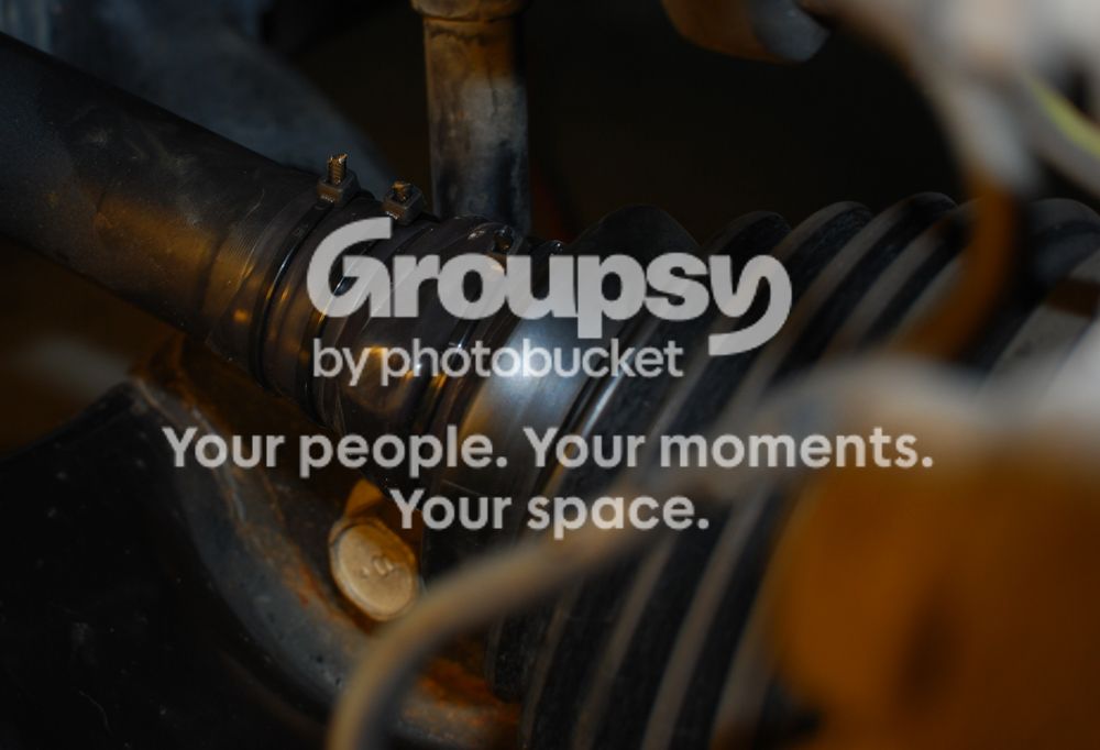

I just did this tonight on my GX. I noticed some grease splatter on the wheel well last night and saw a little bit of grease coming out from the edge of the boot clamp. I used Duck brand silicone tape:
Wrap Fix® Tape
Few zip ties just in case. If you use this silicone tape make sure you stretch and pull it as tight as you can as you wrapping it, that's how it seals to itself.
