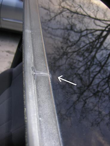

The next series of storms passed through and it left a puddle in my cup holders again. I guess the dealership didn
Saved $598.00 - Yeah me
I placed the superglue in the seams, and we
