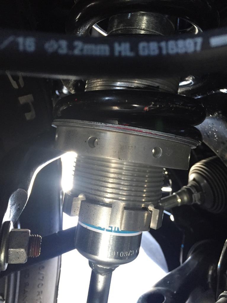

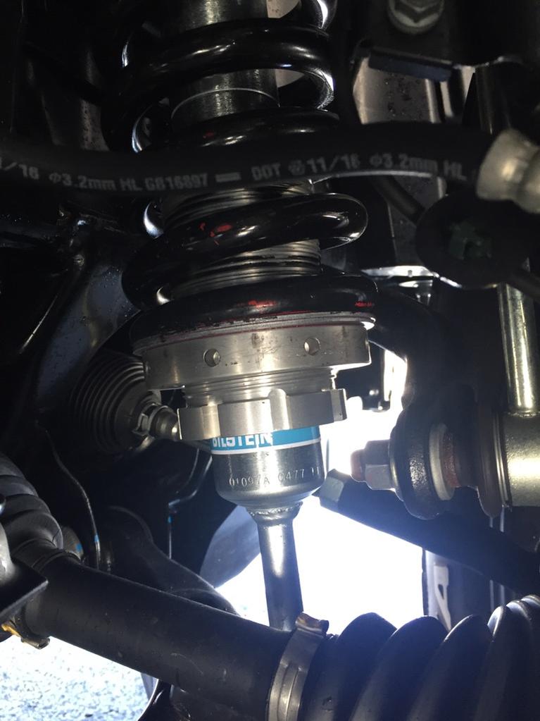

Go with adjustable front shocks so you can level it perfectly. Adjusting as pictured got mine dead on level

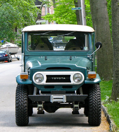

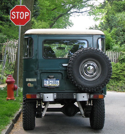

NOT True - I have rebuilt 6 FJ40s, 2 4Runners and 2 Tacomas and they all leaned to the driver side after the springs were broken in with weight in the bed.
Toyotas lean - they do.
All 6 of my FJ40's leaned and I needed to compensate for this in the lift.
My last FJ40 lift was:

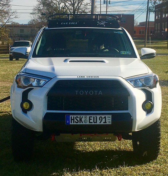

and my TRD Pro lift is still not right - more spacer needed on the driver side -
* trust me on this - I love the trucks, but hate the lean
