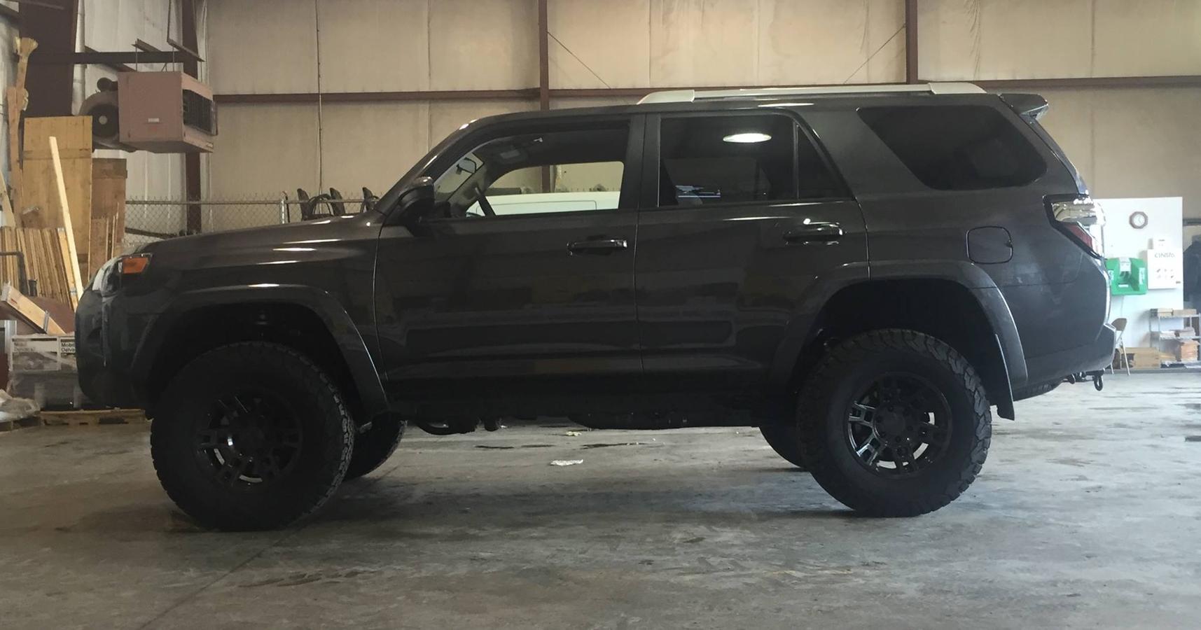

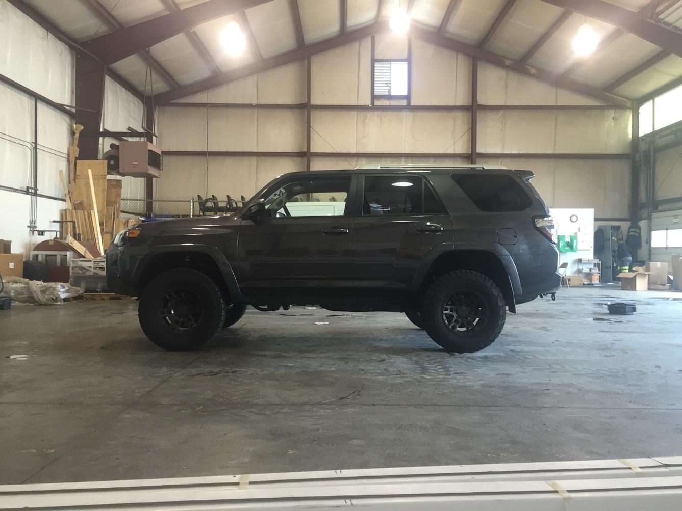

ToyTec Ultimate kit with 700 pound front coils and superflex rear coils. I would go with the 3" rear coils over the 2" rear coils. 2" coils gave it a negative rake, wasn't happy with it. Here are pictures with the 2" coils and then with a 3/4" spacer added on top of them. These pictures were taken right after the install when I still had my 285 KO2's on it.
