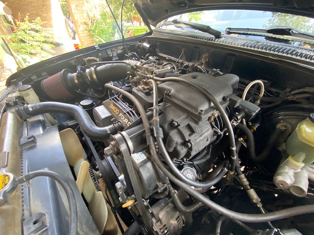

Thought I would share in the event anyone else runs into a similar problem. After the 4WD conversion I finished up the rest of the parts including TRD headers, some new PCed valve covers, VCG etc. Also coated the supercharger, which is a gen 1 that I rebuild two years ago.
Take everything out for a few shake down runs and after a few miles, bam, CEL. This is odd for me as I have replaced everything possibly damn near it with OEM bits and I have pulled that blower probably 20 times or more. I know I didn't miss anything. Pull codes and I am tossing a lean bank 1... SOB. I have a 7th injector and usually run slightly rich.
So.....
- New O2 sensors front and rear
- New OEM MAF was installed a few weeks ago
- Said screw it and tossed in a spare Walbro 450 from my turbo beemer
- Another new TB gasket
- New OEM plug wires
- New plugs
- All vac lines are new and sealed
I finally decided to just check everywhere a vac line terminated. First thing I check is the bypass valve. Remember how I said I rebuilt the blow? Well I did it all aside from the bypass solenoid. Immediately I realize it has NO seal, the diaphragm blew. Quick bypass and the truck is better than even. Jump on Jon Bond, little next day air and BAM. Back in action and better than ever.
Hope this helps someone!

I have a 1st gen supercharger also. What did you use to seal the bypass solenoid? I'm always curious how this doesn't leak more...

When I got mine it was caked with orange RTV. My first thought was "There has to be some kind of sealing method way better than this...". My trick has been to clean the joints of all sealant and run the Job Bond o-rings lubed with some oil.
I agree it is a weird design as the elbow "floats" but one it sees pressure it basically sets the o-rings.
Bypass O-ring set – Jon Bond Performance LLC
This seems to be my issue as well. Ordering those o rings right now.
did you replace only the orings or anything else?
