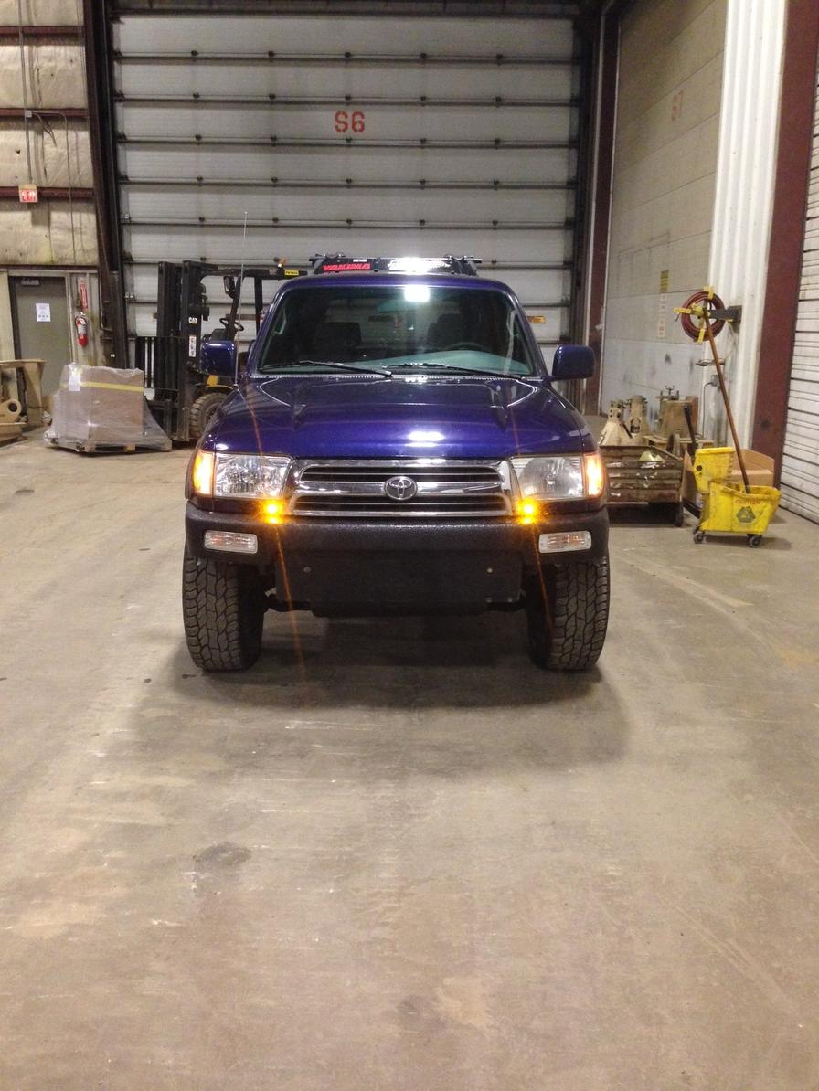

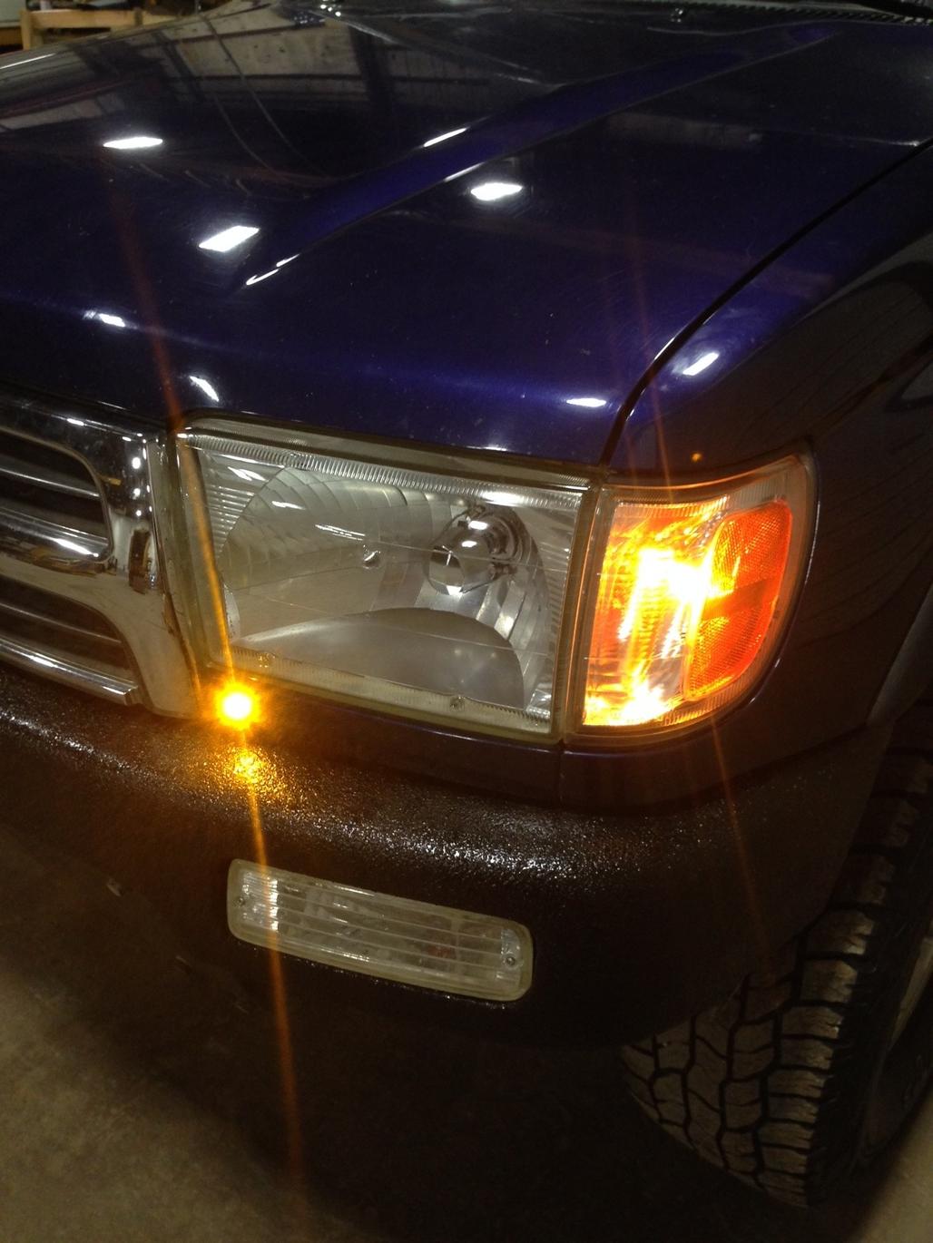

I've always liked the way the amber day time running lights look on the newer toyotas. After weeks of planning it out in my head I pulled the trigger on x2 Oznium LED bolts. I'm more than thrilled with how they turned out. I wish i had done this a long time ago.
I found a blank fuse spot under the dash that was switched on key power. I installed an add a fuse and ran the wires up front.

That looks really great! Was it just a plug n play?
Pretty much. The LEDs are water tight with about a 2 foot harness on each (positive & negative wire). I bought the add-a-fuse at the parts store, ran the positive wire up front and grounded them on the body ground near the battery on the driver wheel well.

What size did you use? And did you just drill through that little trim piece?
Not sure what size I used. But yeah I drilled a pilot hole then slowly went bigger till they fit. Be careful however drilling that thin peice. Its thin metal and my bit dug in and cought and bent the trim peice a little. I fixied it but it was extra time spent on the project.
