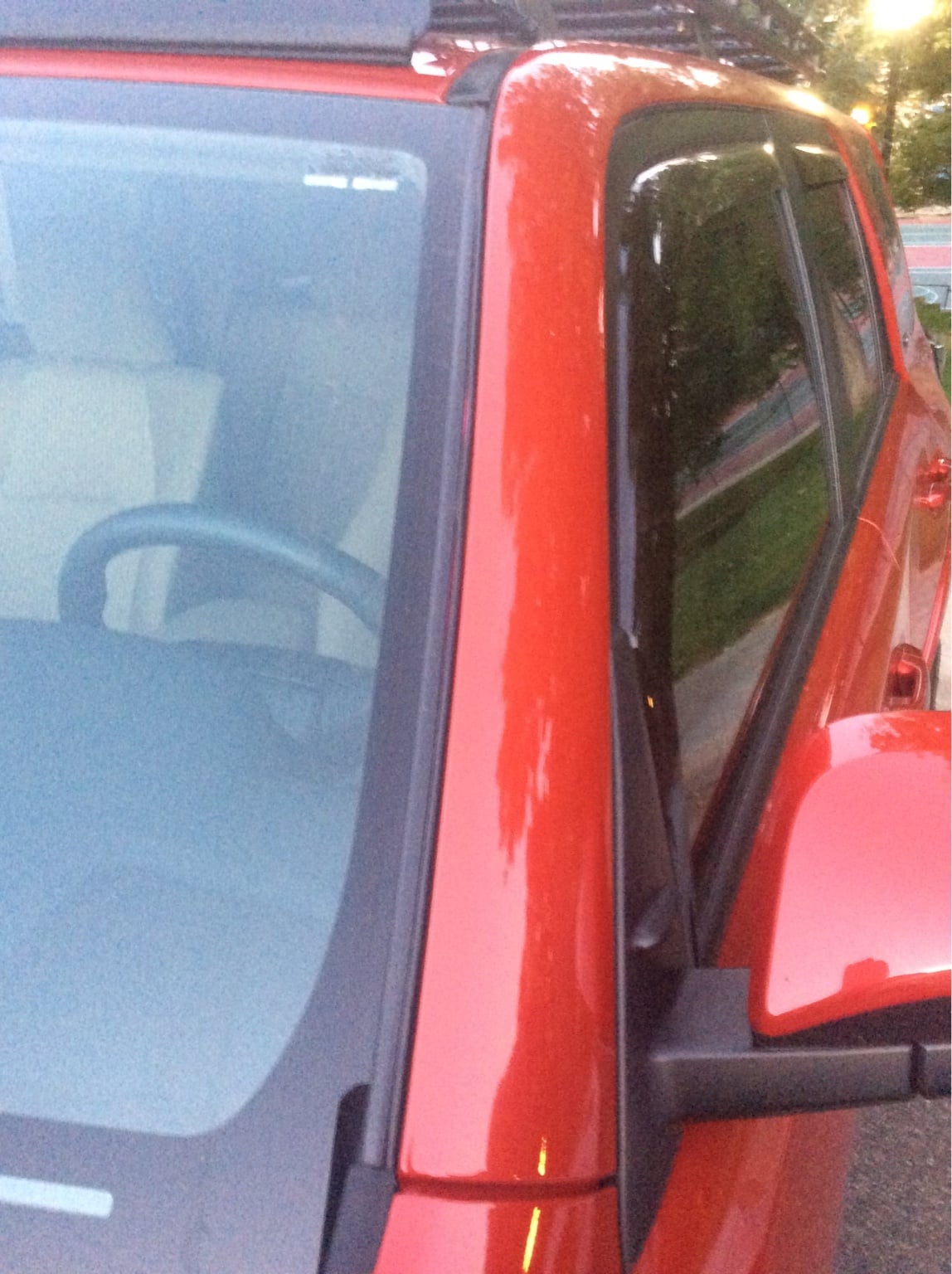

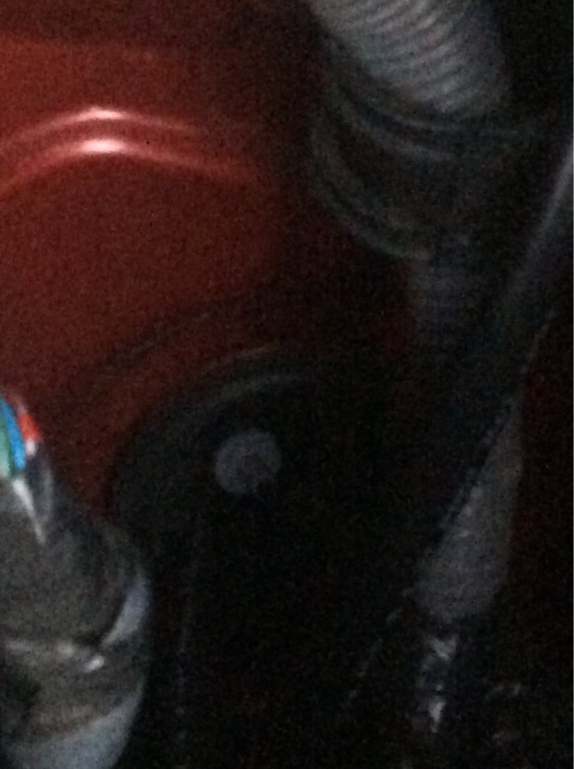

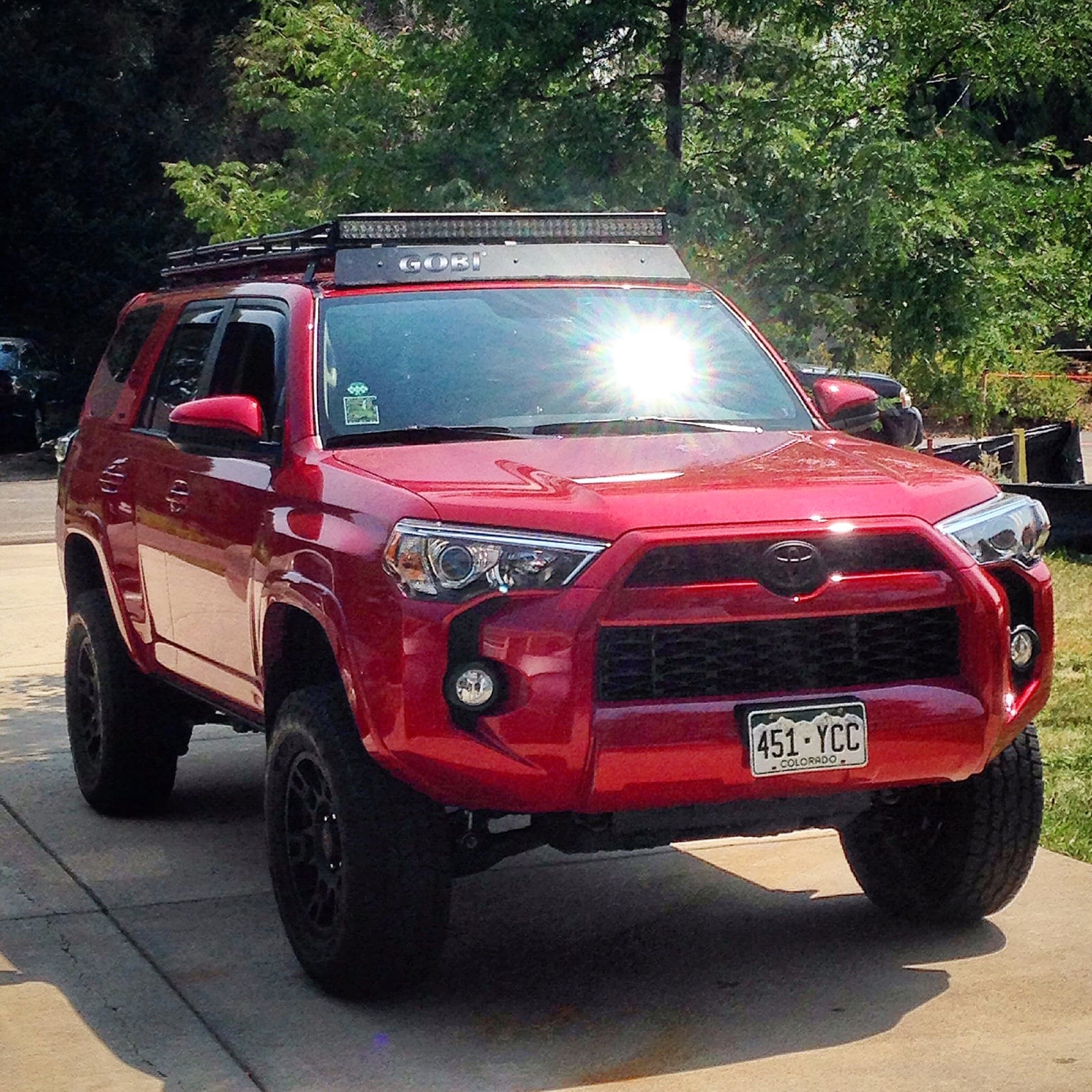

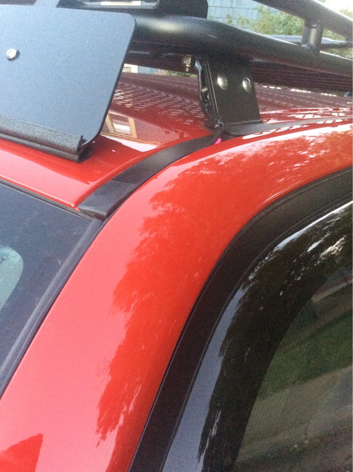

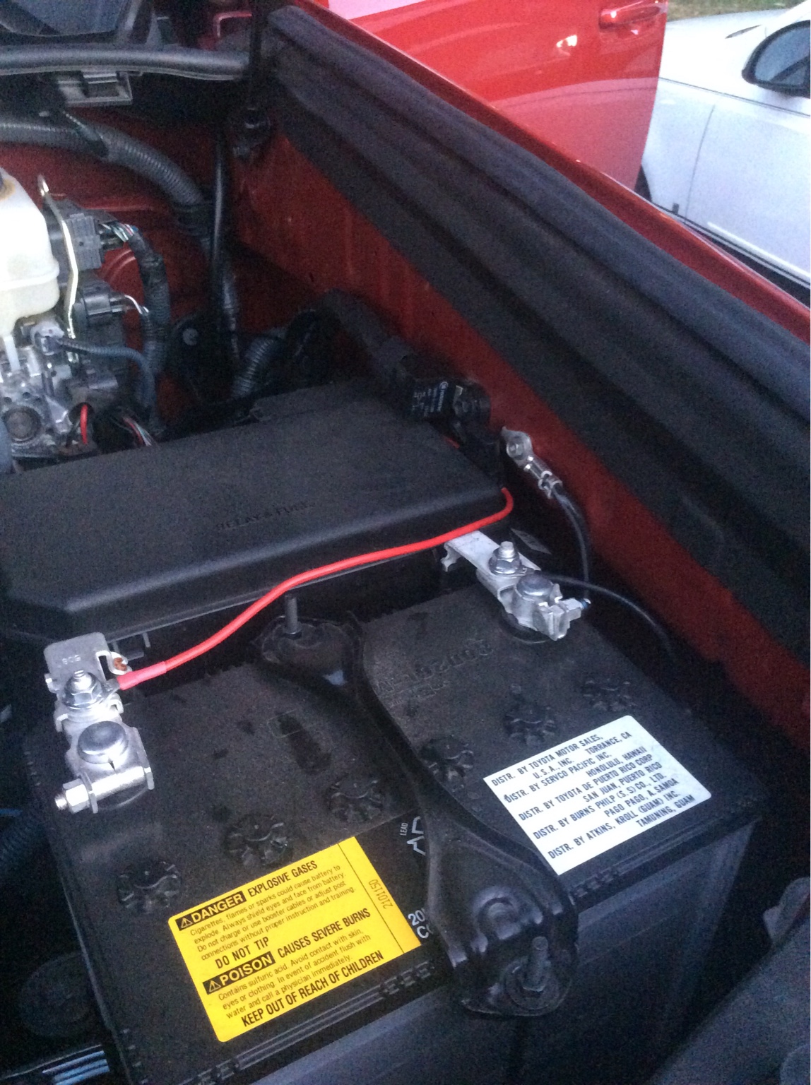

Finally got the rack and light installed. The light wiring was a lot easier than anticipated. From the battery into the cab, I used the hole were the main wiring harnesses went through. Plenty of room, just cut an additional slit in the rubber housing that seals the hole in the firewall. Going from the battery up to the light I ran it to the windshield, for the length of the windshield I removed the black housing that the wires were in. I tucked the wires in along side the windshield with the negative wire in top. Very clean look an barely noticeable. From the top of the windshield to the gobi mount, I tucked it under the black rubber that goes along the roof above doors. Once to the mount, just ran up along the bottom rack and plugged in. Works and looks great. I will post some more detail pics soon.

Clean Wiring
Thanks for posting the pics and details on the Gobi Rack LED wiring. Your rig is looking good!
I was planning to run wiring to the back and up the rear hatch, but this is a much shorter run and a clean install. I will be doing this same wiring once my Baja Rack arrives, plus to the rear for my camping lights.
