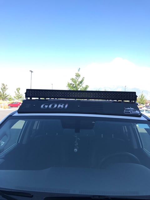

Finally got the rack and light installed. The light wiring was a lot easier than anticipated. From the battery into the cab, I used the hole were the main wiring harnesses went through. Plenty of room, just cut an additional slit in the rubber housing that seals the hole in the firewall. Going from the battery up to the light I ran it to the windshield, for the length of the windshield I removed the black housing that the wires were in. I tucked the wires in along side the windshield with the negative wire in top. Very clean look an barely noticeable. From the top of the windshield to the gobi mount, I tucked it under the black rubber that goes along the roof above doors. Once to the mount, just ran up along the bottom rack and plugged in. Works and looks great. I will post some more detail pics soon.

Turned out great. Thanks for all the info everyone.
Just wanted to say thank you for the information in this thread. No drill installation went flawlessly. I now have a light bar bright enough to cook the undead.

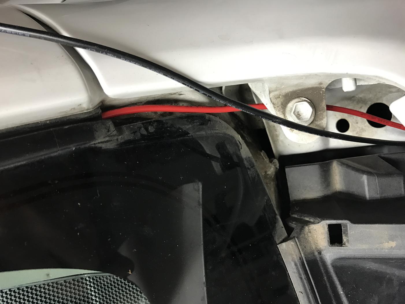

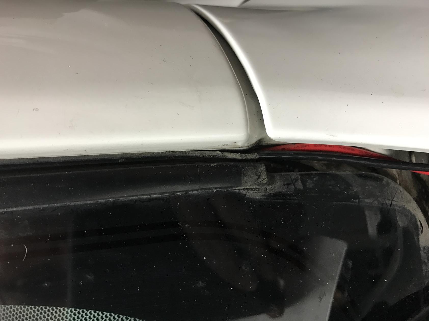

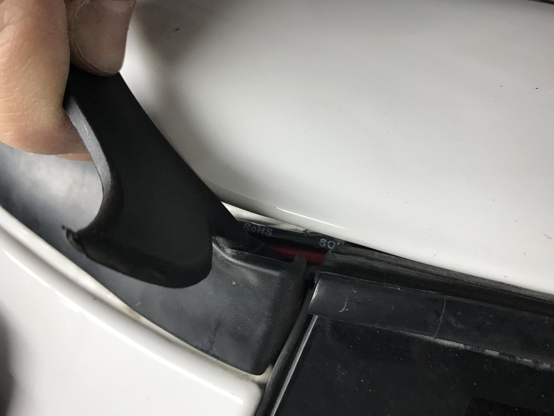

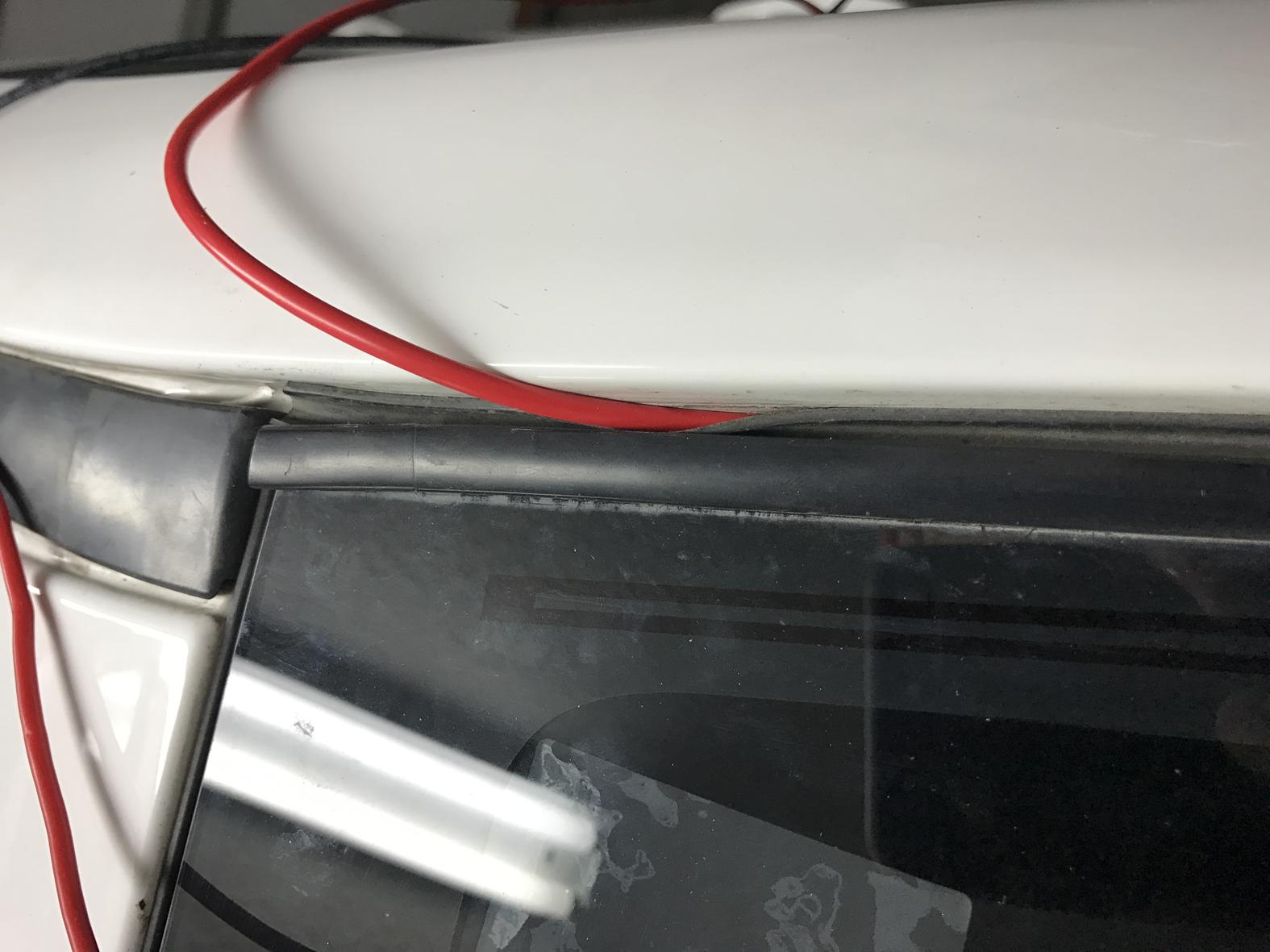

Here's are some close up. Pics are t the best because of my iPad mini resolution.

Can you do me favor and take a pic of the weather stripping at the top of your windshield (between the gobi wind deflector)? Pretty sure something is supposed to be there on mine...
Thanks
Bump. About to do this, and have the same request as the last post for more close-ups of the wire leaving the stripping near the rack. Cheers!
