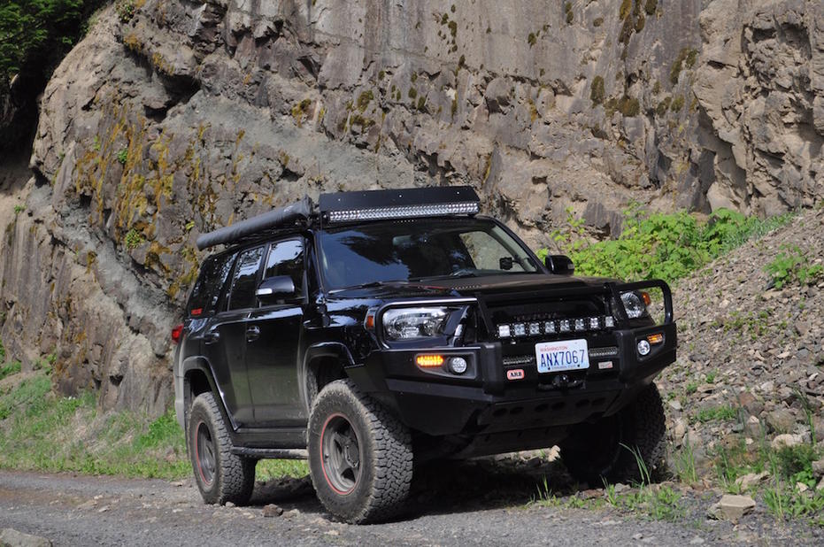

You could always undermount a larger bar like I did and move the wind deflector to the top.

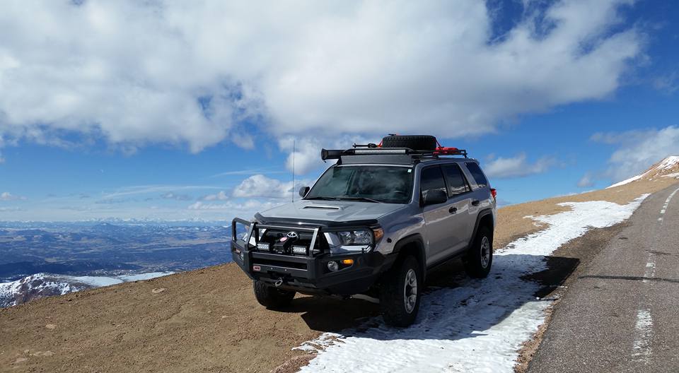

Posting this for [MENTION=133253]Spitfire[/MENTION]...he's busy moving to Utah...nice truck at Pikes Pike
Cut the two vertical bars off to fit the 30" light bar in there

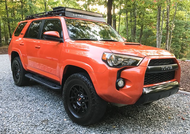

40" Curved LED Bar Installed
Not wired Yet but Finally managed to get it installed they way I wanted it, and with no wind noise.

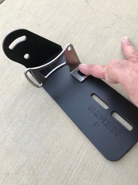

I ordered my Gobi with the Rigid LED bar as an option. Since decided to swap in a Baja and working on the install. Either will fit in a 40" - either curved or straight.
Here's a picture of the Gobi supplied bracket (the black one):

Interesting, the included Gobi mount that you show is much nicer than the one I got that came with the no-rise option. The one I got is just an "L" bracket with a single open slot cut into it.
