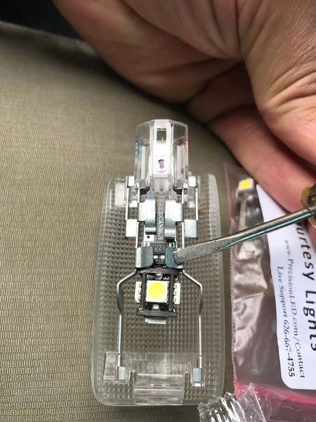

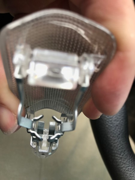

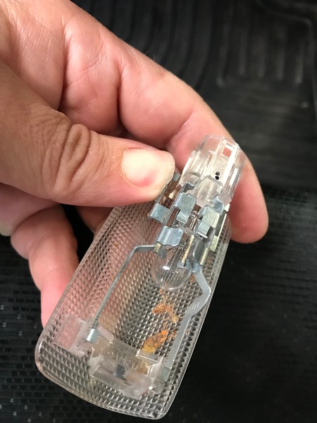

Here is a pic of the housing.

I think your issue is the LED itself. Check the distance between the two metal connections (cathode and anode) that come out of the LED lens and connect with the harness. I had an issue with a few of mine for the interior and all I did was move that metal rod a bit to make a better connection.
I'll give that a try.
I initially thought it was these tabs:
But, you are saying that it may be these instead? Where the "socket" actually is?
