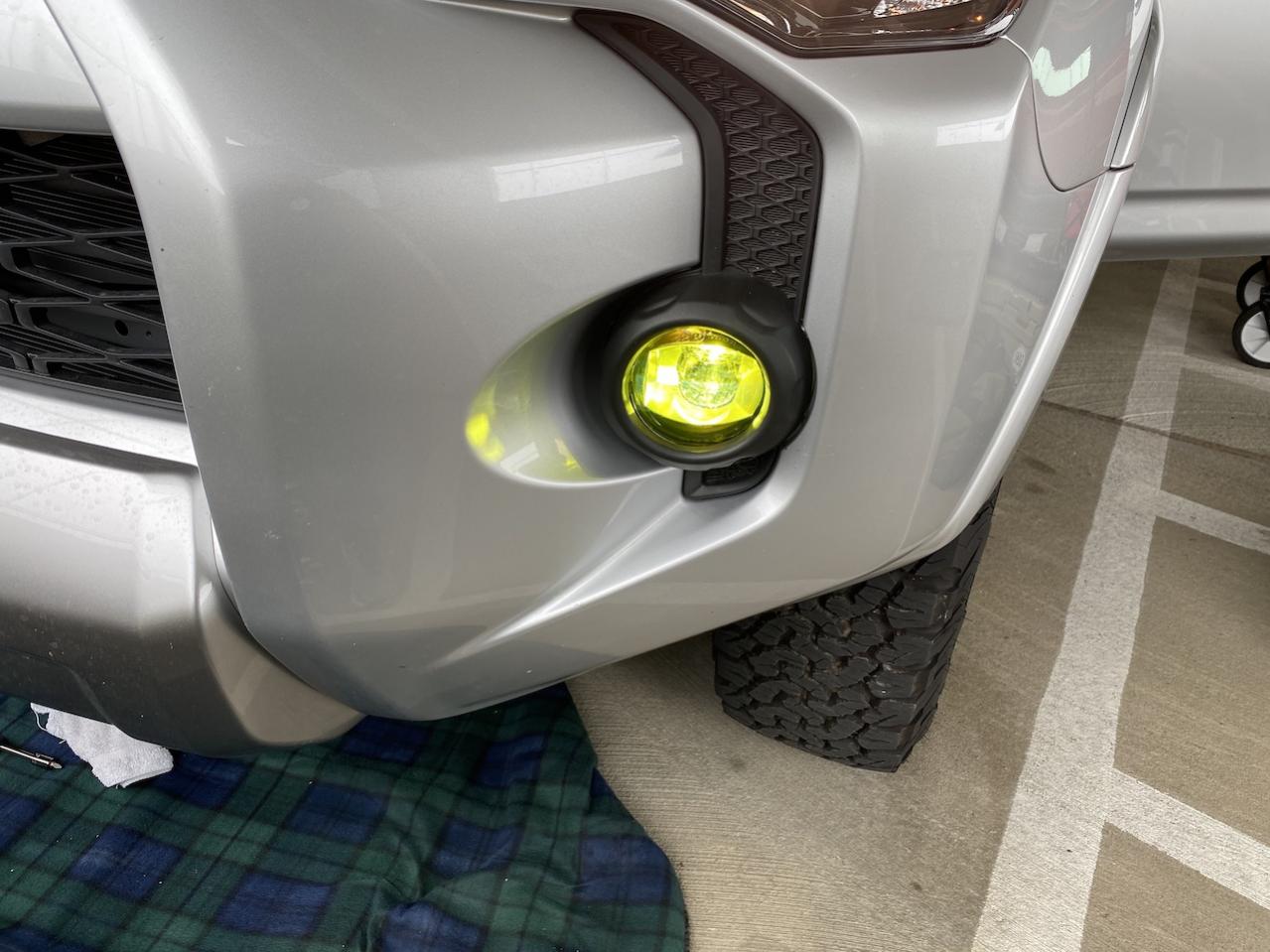

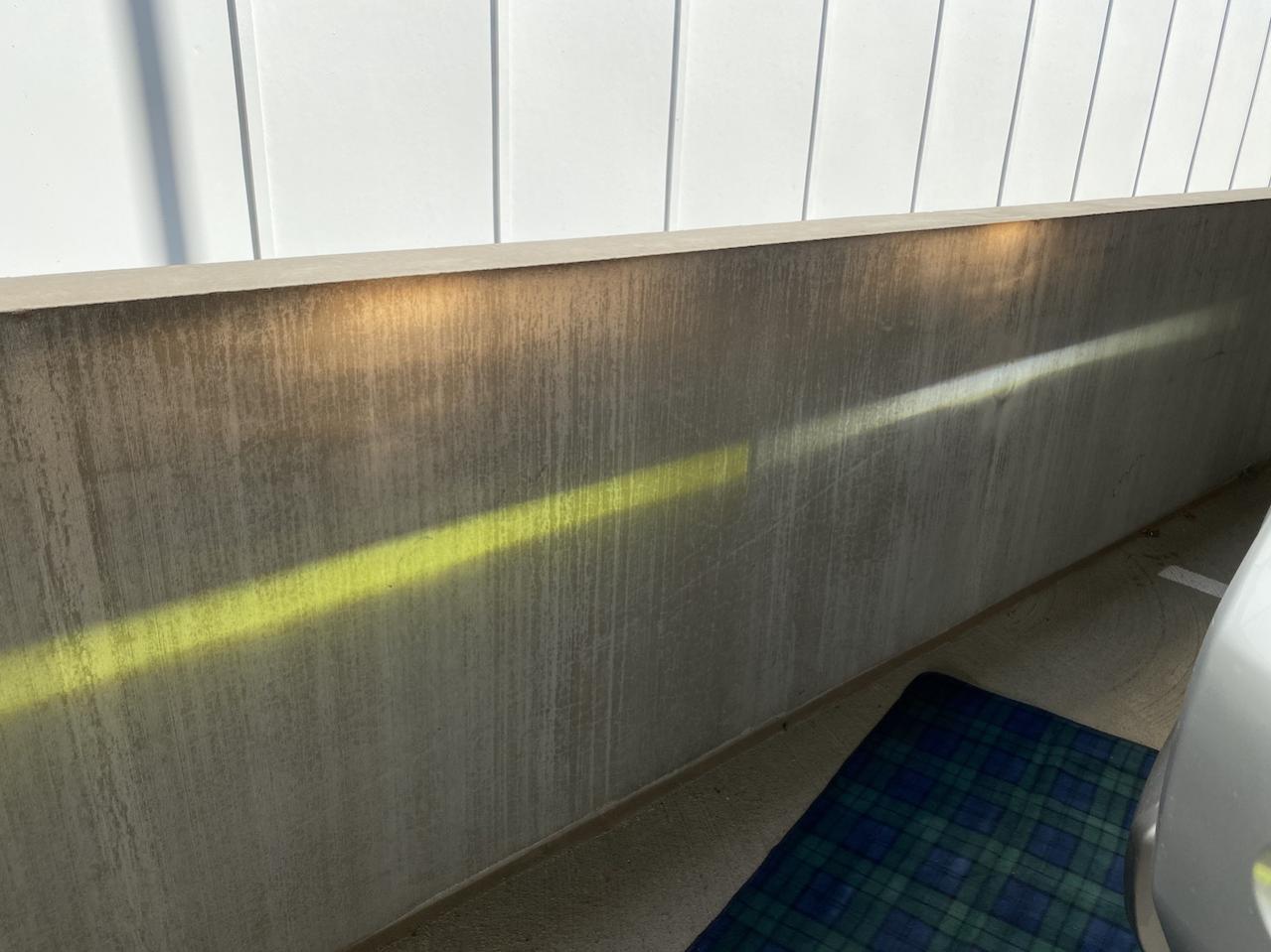

Fogs are H16 and I'm not aware of an upgrade. On my '10 TE, I used these Hella H16 bulbs which were great in the rain, snow, etc.
On my '20 ORP, I upgraded to the TRD Pro LED assemblies then put yellow Lamin-X on them to kill the stupid blue-white light that is the opposite of what fogs should be. They are very good lights and project well... very wide pattern and sharp cutoffs.

Damn, that looks good on the fogs!

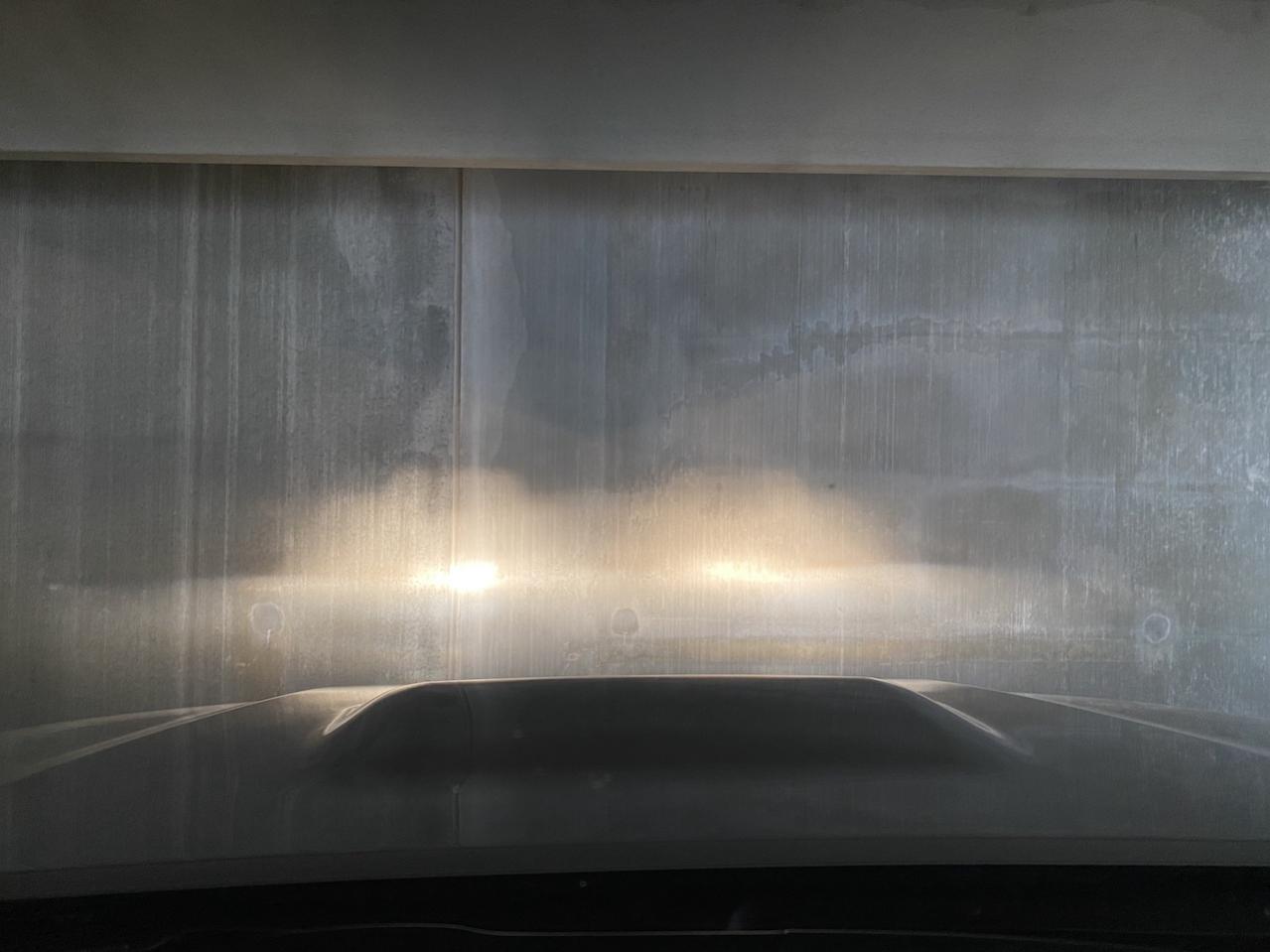

Just an update. I did the 9011 upgrade on the high beams today. The left side is the 9011 and the right side is the original 9005. Much brighter and not as yellow. And they will dim on the DRL setting.
