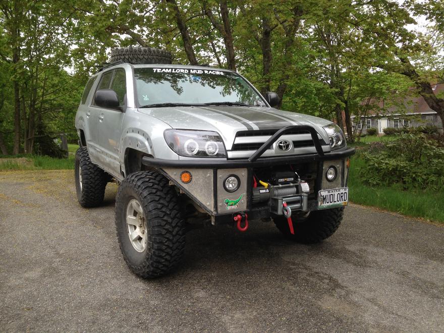

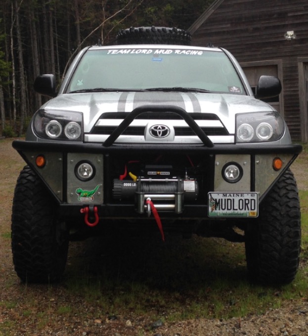

I purchased some LED Halo headlights (lens and all) on ebay for about $150 a set. They are freakin' sweet! I'll post a pic soon. The best part is it replaced my very foggy OEM plastic headlight.

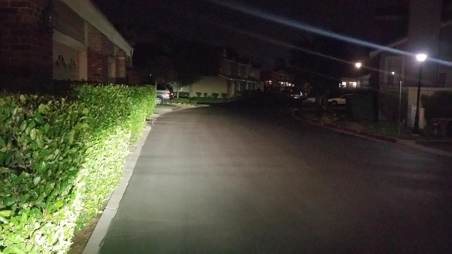

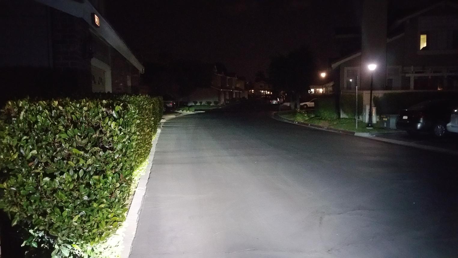

I tried this with HID before and the results were no good, so I decided to try again using LEDs. I bought a pair of these off Amazon since they weren't that expensive:
Amazon.com: Car Rover 30W Cree Chips 2S LED Headlight Super Bright 3600LM 4300K Headlamp - Replaces Halogen & HID Bulbs - 9006(HB4): Automotive
The first image shows the light output when *only* the driver side headlamp was swapped with the LED bulb. The passenger side headlight is still using a Philips 9012 HIR bulb.
The second image shows the light pattern from a 2008 BMW 328i with factory HIDs. Note how on the first image, the building in the distance is almost completely lit up by the low beam LED - that doesn't happen with the stock BMW headlights or when using stock halogens / HIR bulbs in the 4Runner. That kind of light output will blind oncoming drivers. I'm not able to adjust the reflectors low enough to create both a satisfying projection pattern *and* not disturb oncoming traffic.
I wish there was a simpler headlight upgrade for '03-'05 models short of a full aftermarket HID retrofit but it is what it is...

I'm not usually a fan of full aftermarket lights, but this sure is an upgrade from our very foggy OEM lights.
