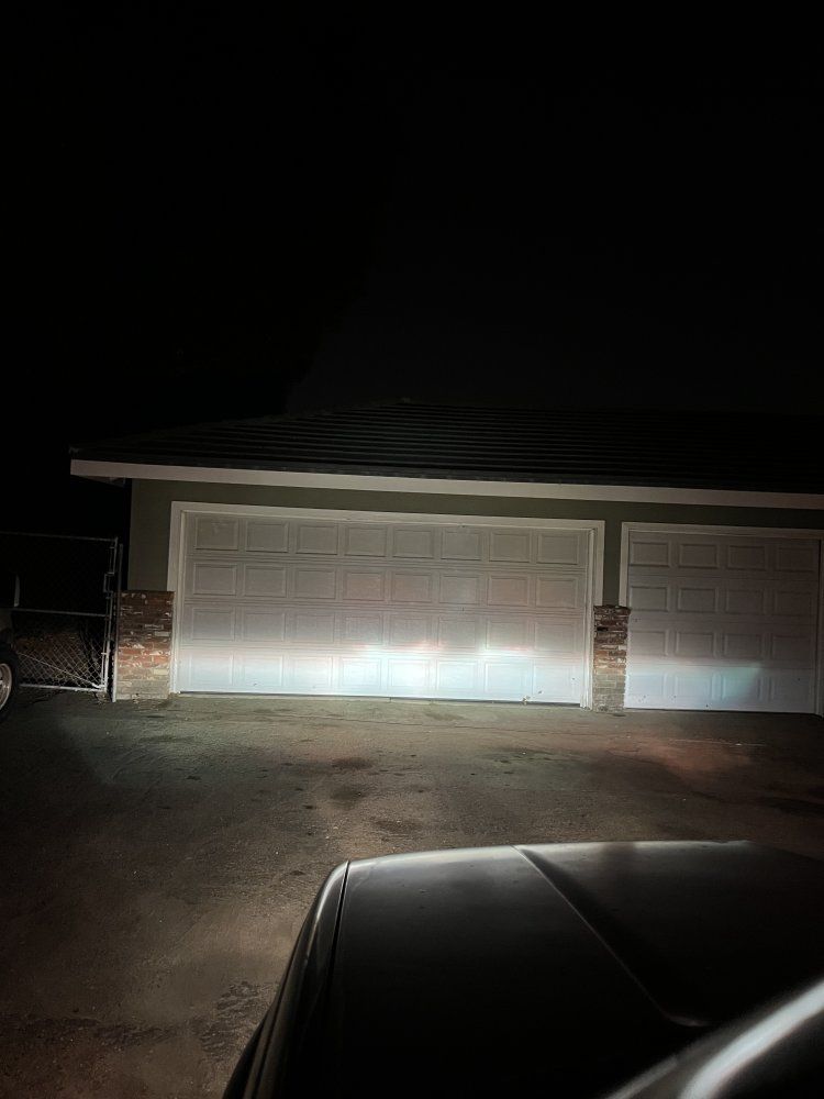

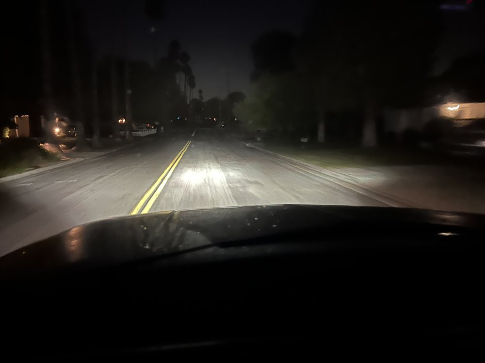

Some pics of the HID low beams on my ‘99 K2500 Suburban.
The Suburban OEM housings are for halogen bulbs. They have ribs in the lenses which would scatter light all over if used with HID bulbs:
https://www.carparts.com/details/Ch...ampaign=20161732550&gad_source=1&gclsrc=aw.ds
I use the housings with euro clear lenses, but they must have a certain style cup over the low beam bulb:
The cup cuts the glare you speak of and cuts a hard horizontal line on the beam, which you can see in the pics of the lights pointed against the garage. The line has some dog ears sticking up but is generally a hard line. It is not as sharp of a line as you’d see from the 2023 ORP LED housings, but decent enough.
