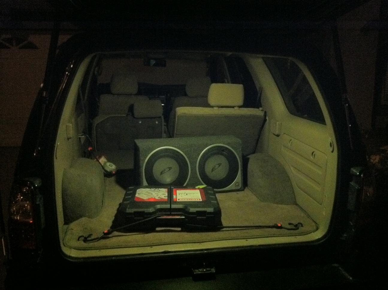

cargo light, there is a small notch just big enough for a tip of a knife, insert knift and carefully pry open the cover

all 4 bulbs are the same 30 mm

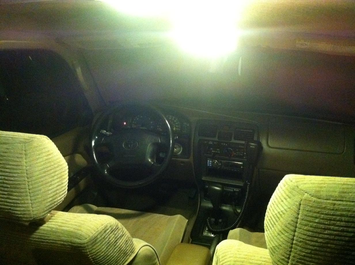

I upgraded in the 99 interior with the 25 LED superflux ozniums. It's like the sun in my 4Runner :) Both map lights and both dome lights.
Works in the pre99 dome lights if you want. Takes some cutting and such, but if you have basic competence, you should be able to do this.

Oznium LEDs in the map lights must be insane. Which one did you go with COB?
I have the 25 in my dome light and that sucker is bright.
