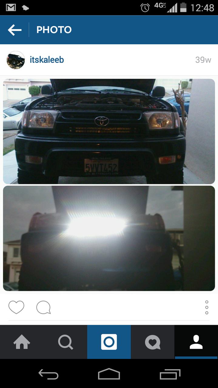

I've done this. I was able to fit everything together without cutting the grill. I did drill two holes in the bumper, but I used button bolts and they end up behind the grille, out of sight. More pics in my build thread, lemme go find them.

That's exactly what I was thinking. What brand did you go with?
When you say button bolts behind the grill, do you mean the 1-2 inches of overlap the grill has on the bumper? I could live with that since there would be no visible holes or bolts.

It's a no name brand, from amazon somewhere I think.
That's correct. Ive been meaning to paint the tops black, but sincd i cant see them already i always forget. The setup has been with me through Lost Coast, Prairie City, Hollister Hills and has not let go or budged a bit.
My friend has my truck until 4, I'll get better pictures for you!

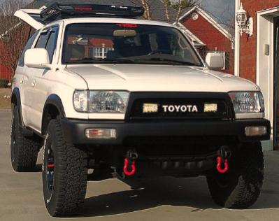

I'd be interested to see some designs as well. I'm considering doing the metal mesh thing that everyone does and was thinking it might be cool to actually cut a hole in the mesh and have the light bar sit flush.
Something like this (I apologize in advance for whoever truck this is that I butchered with my photoshop job, lol)
I missed your message somehow. I ended up cutting the lower plastic valance and putting it here. There's some predrilled holes on the bottom of the chrome bumper section I uses and only had to slightly re-drill holes on one side. It's been there for several years and is rock solid still.
If you go the cheap Amazon route, I recommend also drilling some vent holes on the top or back of the casing. I tried to seal it with silicone but water always got in and would fog up. As soon as I put vent holes it never fogged up again.

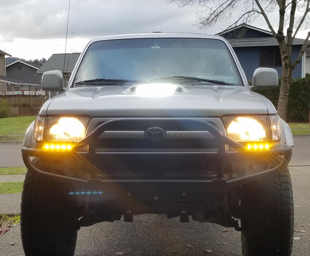

I have a C3 bar from Raxiom and it might be along the lines you're looking for. About as bright as a normal headlight, but projects light a little wider/further than our halogens. Definitely not blinding by any means
Ironically just snagged a new bar because this one isnt bright enough for a flood light
Edit: Just noticed this is a 5 year old thread lmao whoopsie :boink:
